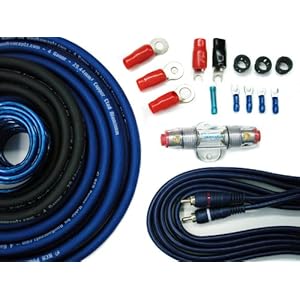

The only Major concern i would have is the amp kit they sold you.
Lets Look at this Graph i got off of KnuKonceptz website, it's a good reference.
Okay where it says Amperage on the Left side of the chart, that's the Fuses on your amp or amps. I believe that Autotek has (2) 30 amp fuses so if you add them up it's 60 Amps.
Your kit comes with 20 Ft of 10 Gauge Power wire, For our little cars we may use about 10 Ft. That would be the Bottom Number on the chart.
So when you cross that the smallest gauge wire recommended would be 8 Gauge. Okay now you make think the site is just biased towards selling you there products, lets look at the actual product description of your Amp Kit
I pulled the info from here : http://www.sonicelectronix.com/item_...n-AKIT10J.html

See even the manufacture rates there amp kit Very low on the wattage.
For that sub and the load it's putting on the amp the amp kit is fine for now, but if you ever added another sub I'd worry.
In the end how do you feel about your system ? Is it what you wanted or do you want it Louder ? Did the place who did you system give you any type of warranty with there work ? Are they going to back the manufactures 1 year warranty ? Did they give you all the paperwork that comes with the amp and subs ?
You didn't get ripped off but if the answer is no to all of the above then you may have an issue in the future if anything ever goes wrong with one of the components in you system.

On the tint they usually offer Lifetime warranty as long as it's the original owner of the vehicle, and it's if the tint fades or bubbles.
On the Audio equipment just see if they're gonna Honor the Standard 1 year Manufactures Warranty, and back up there installation. I honestly don't see your amp or sub malfunctioning in that time period but it's more of a " peace of mind" type of thing knowing they stand by the product(s) they sell.
What i would say is " I want a sturdy foundation if i ever decided to build on the existing components you are installing in my vehicle" because with the wiring they're providing you , you're going to have to buy a whole new amp kit along with whatever you're upgrading if you ever decide to. Kind of put it in a nice firm way " Lets do this right the first time . "
If i can recommend you an amp kit that's is pretty decently priced here's the link
http://www.amazon.com/gp/product/B00...=A1NLNJ4Y2QP8Z
http://www.knukonceptz.com/productDe...?prodID=KCA-K4
Take your time and read the reviews. I can see them charging you $50 - $75 for that gauge wiring, if they do that then i'd just take another week and order that kit from Amazon. Don't rush and be Patient ! If you have any other questions feel free to ask we're here to help.

I have KNukonceptz 0/1 going to my amp,it is very good wire,so flexable you can tie it in a knot,but it has lasted 4 years now and has no problems.

I'll switch my wire to Knu's brand this year, I've used a few different of the cheaper brands and the majority of the time they have a thick jacket and not so much wire.
I would like to see the wire in the 10 gauge kit they sold to the OP, Just out of curiosity .

I have this
http://www.knukonceptz.com/productDe...?prodID=KFX0BK
20' length that I cut 3' off to make the ground wire,it goes from battery and along firewall to passenger side and then up the pasenger side to the amp connection on the drivers side.
It is very heavy wire,20' weighs in at little over 9lbs.....doesn't seem like a lot till you pick up the roll...lol
It really freaks out people when you tie it in a knot too.
