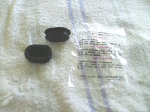

So I found these in my glove compartment
the little bag says:
IMPORTANT
TO PRE-DELIVERY INSPECTOR:
INSERT THESE RUBBER PLUGS INTO THE HOLES OF THE CENTER FLOOR SIDE MEMBER EXTENSIONS.
anyone got a clue where they go?

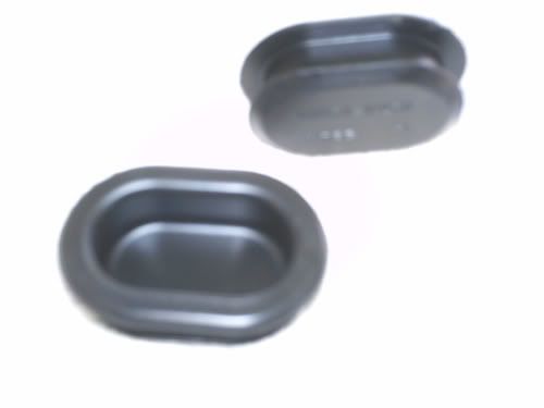

I looked under my car and i found this on either side
it looks like the plug would go in there perfect, but i'm not sure
Can someone else with a liftback look under their car and see if they have rubber plugs in them? they're in front of the rear wheels & take a pic of how they go in (if they do go in there)

Mine came installed.
Just went out and took a picture for you to use as a reference for self installing.

those go in the undercarriage ( frame ) on the left and right sides not far from the rocker panel and close to the rear tirewell . They're supposed to be installed by the dealership . Not a very difficult task . Just use piece of cardboard to lay on and not your best clothing . While you're under there , you may want to check all plugs for being loose or possibly missing . There must be at least 15 ( or more ) of those scattered about the undercarriage of the car in many shapes ( round , oval ) and sizes . They do become soft from heat and shrink from the cold which can make them loose . So , may want to give a checkup every 6 months or so . Can lead to water , mud , or critters to enter car .
