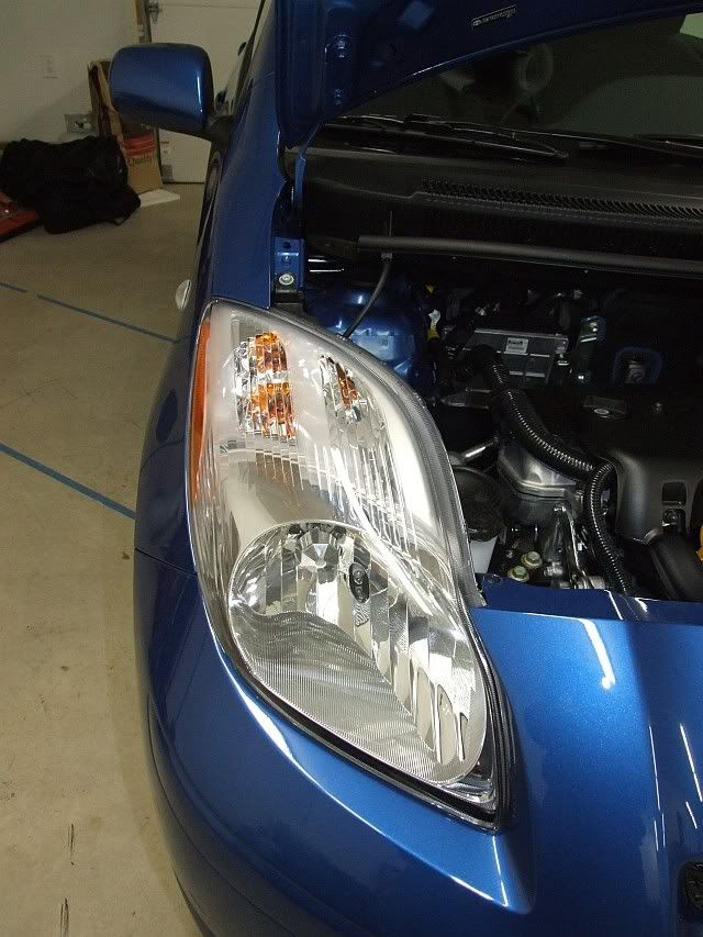

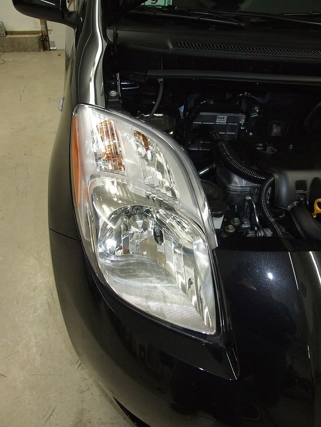

Posts: 13,460
Here are some pics for comparison:
08 Headlight:
09 Headlight:
All sheet metal (i.e. hood and fenders) is the same. The person who did the 08 to 09 conversion found that one of the mounting tabs for the 09 headlight did not line up with the mounting tab for the 08 headlight. Other than that it sounded like the conversion went well, so going in the other direction should not be an issue either.
