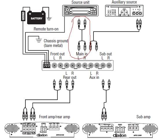

Equalizer Question
Which would be the "main in " From the Source Unit if you have the following outputs: Front, Rear , Center, and Sub

Brand doesn't matter.. the "Main in" thing refers to the source... is the main an Ipod, a Sat Radio, or a deck... The eq sounds like it functions similar to a home theater receiver... pick what you want.
would be the front RCA's (from your deck)...
so you have a 5.1 deck?
do you plan on eq-ing just the fronts?
parametric or graphic, how many channels total do you have (on the eq)

Clarion EQS746 1/2 DIN Graphic Equalizer with Built-in Crossover
Product Description
7-Band Graphic Equalizer 6-Channel / 7 Volt RCA Outputs (Front/Rear/Subwoofer) Adjustable Master Volume Level Control Adjustable Subwoofer Level Control 2-Channel RCA AUX Input with Adjustable Gain Selectable 12dB Low-Pass Crossover (60Hz or 90Hz) Gold Plated Terminals Dimensions:7"(W) × 1"(H) × 4"(D)
Another question is the 7 Volt RCA Outputs will effect my amp in what way ? I believe the Output from the Player is around 2.5V
And i'd like to use the eq to Run my Front, Rear and Sub.
