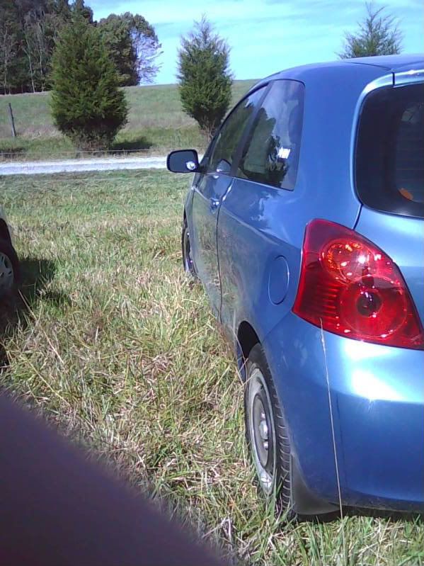

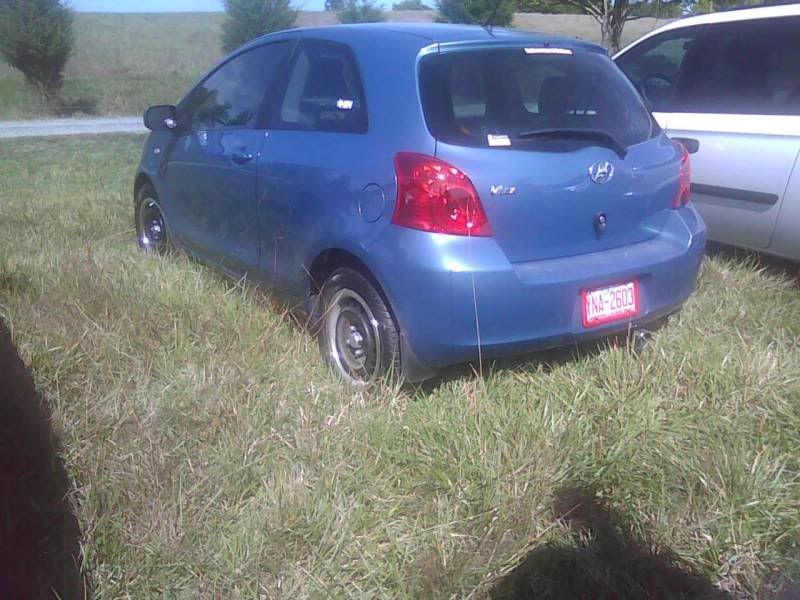

I got them install today FINALLY.
An hour long job took me four hours...
entirely my fault.
I borrowed (yes, you can do this with any of their tools) a torque wrench from O' Reileys.
Then got the allen key adapter socket (hard to find in metric for less than 10$).
THEN the drum brakes WOULD NOT come off! :[
I searched around the net and turns out if you simply cannot tap them off with a hammer then you can get (2) M8 bolts, and screw them in the hub and it pops off really easy.
The rest was pretty easy but the actual spacers wouldnt slide on because of the rust so I just had to bolt them on and pull them into place...
anyways...
very easy if you have the right stuff.
My helper couldnt tell a difference, but I can....
Heres some crappy cellphone pics from today... I didnt mean to take pics of the new spaced out wheels .... my car just looked lowered sitting there in the grassy field, LOL.
-Jen <3

weak sauce no more....
here's some cellular phone pics to keep you happy til the nice clean ones are taken tomorrow!
:D
-Jen <3
