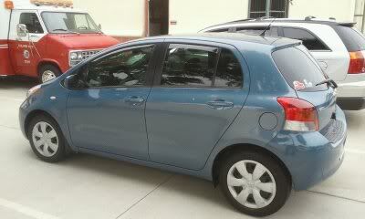

hello all. i am pretty new here but i just picked up a 2010 yaris and i am looking at making the car look more aggresive and cooler while maintaining a functional approach.
i have been researching wheels/rims and tires for a short while and i have run into a block. tires are new me as well as wheels and i need help finding the right wheel and tire package that wont rub. i h8 rubbing. i dont plan on dropping the car or update the suspension till i need it if that helps
this is what i got: (all stock except for the tint and in channel rain gaurds.
im in southern california
thanks

xxr's are gorgeous but there is a big difference on the look on +40 vs +20 offset...

You mentioned that you DON'T want to rub. So do not choose +15 or 0 offset. +40 offset is fine.

okay. so i was doing some homework (wheels,offsets, yarisworld) and so, sorry for brining up the newbie question over and over again....
it sucks how the offset is so little for these rims. thanks for the help everyone. ill have to figure out what rims will work best that i wil like
