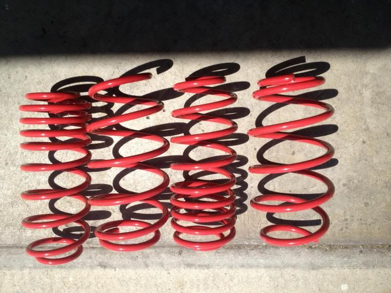

Decided to be a guinea pig and tried these ebay springs out.
Picked them up for $80 shipped to my door.

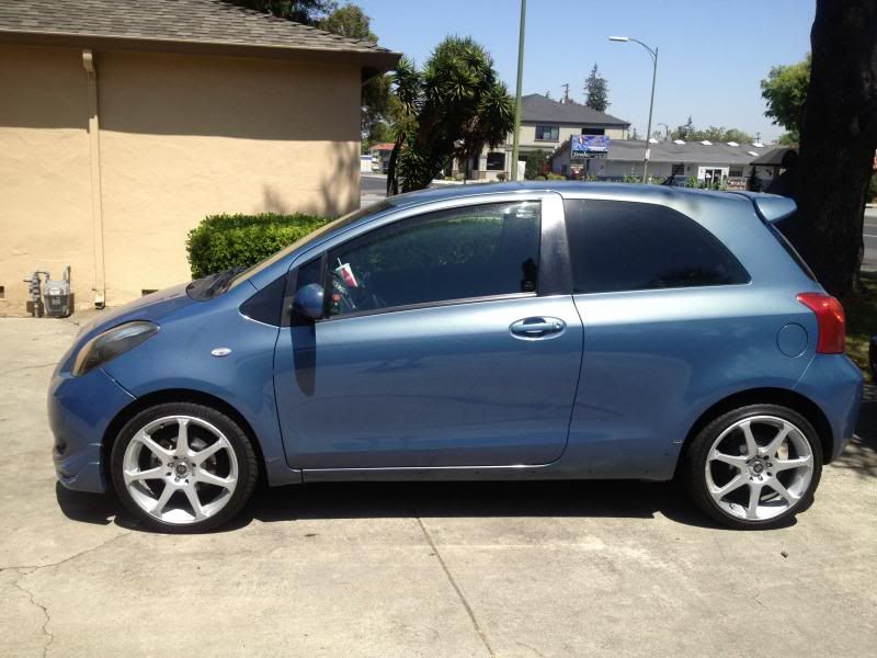

They claim to be a -1.9" drop front and rear. I have no idea what the spring rates are. Here is a before pic.

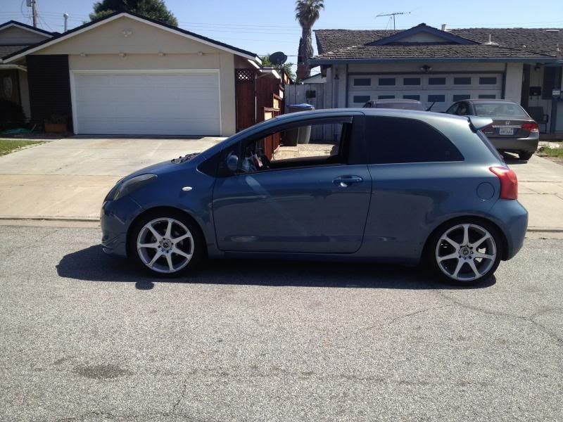

4x4 status. Then about a 45 minutes later here is the end result

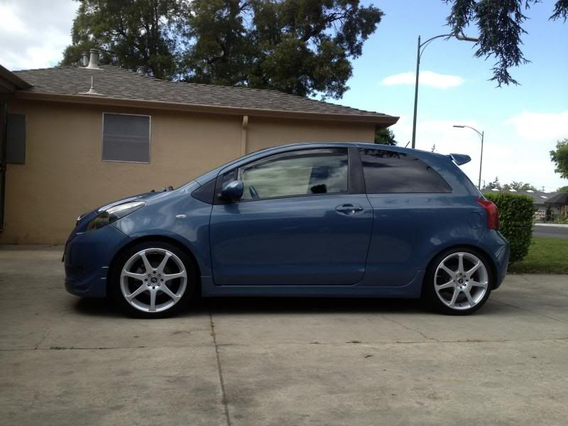

Another one.
They are just as low as my tein s-techs were. The ride is comparable. Handling is way better then stock.

Looks like the rear springs need about a 10mm spacer

Yeah i lost the rubber pieces a few installs ago. its just metal on metal. After riding around for a few days the ride is ok. Its not as nice as my tein springs were. The teins gave a smoother ride, these feel the road alot more.

I agree with Malibu. I really like the low you get in the rear but it looks awkward since the front doesnt go as low.
