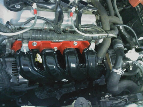

Finally installed 1zz TB and Ported manifold. (and throttle body spacer)
http://www.yarisworld.com/forums/pic...pictureid=6127
i had to modify the intake by cutting about 1/2 in off where it comes to the TB so it would seat properly.

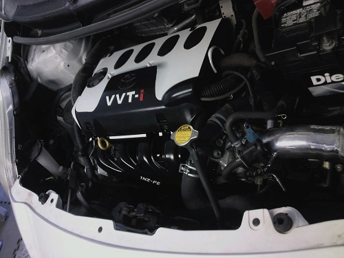

here it is with the engine cover. you can't see the red in the picture, but it looks good when you can see it in the darkness of the shadow in real life.
http://www.yarisworld.com/forums/pic...pictureid=6128
i like the spacer! everyone always asks, "is that a block of wood?"
ha!
