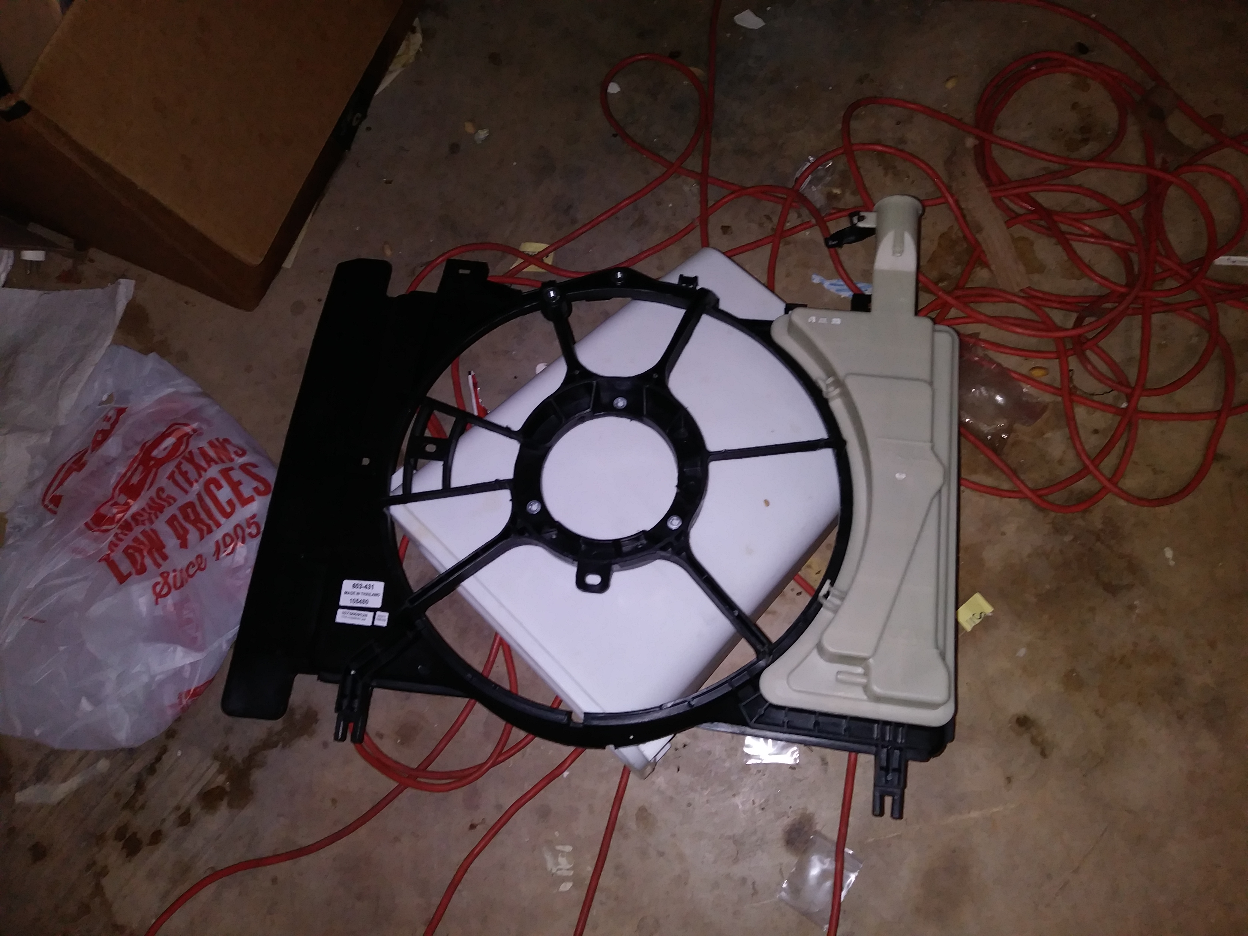

here is the new tank / fan assembly that we got fri, that we have not had time to put in yet. :(

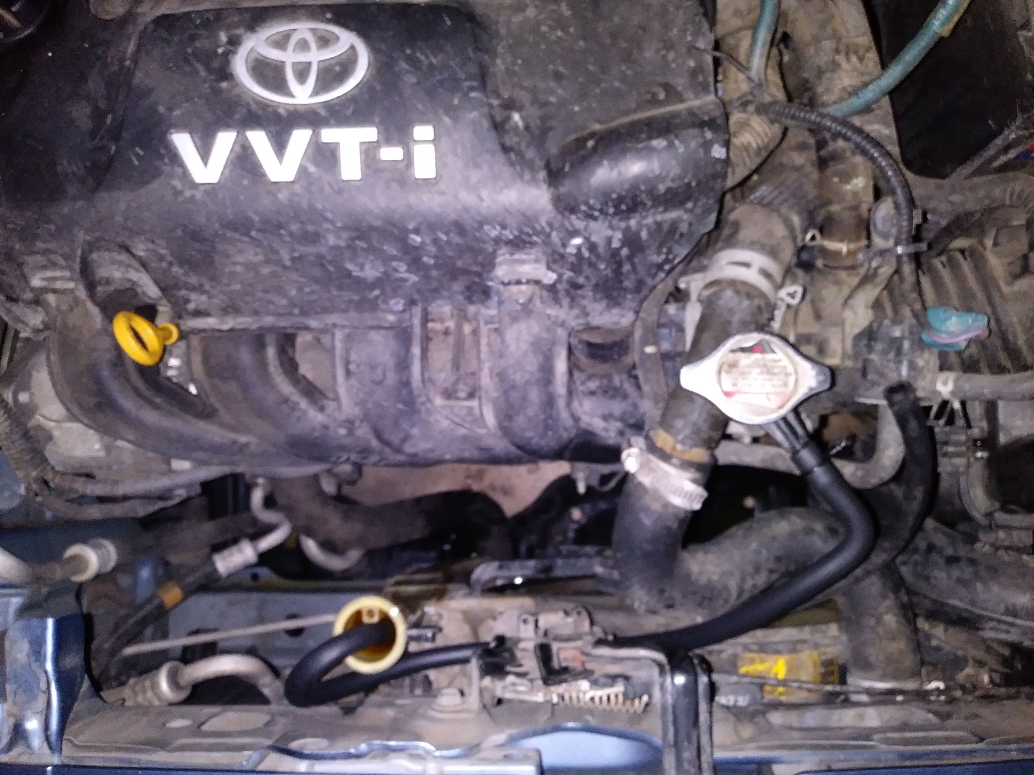

And the Temp fix for now till it can be put in.

sorry for the crappy pix
Will clean up the slashes after the new tank is put in.
