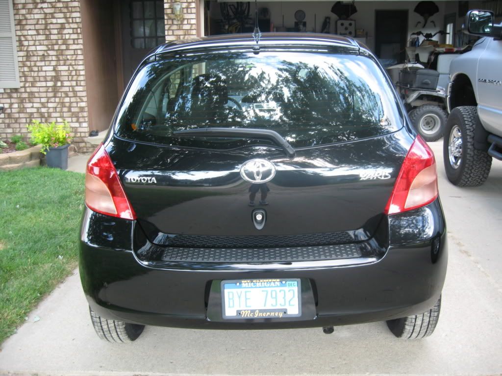

I (the wife)have an 08 yaris(black),How do you remove the toyota emblems,and does it look funny removed,because of the indent(circle) thats there.
Is it an adhesive holding it on?
Any pictures of them removed
Here is the front emblem
Here is the rear
Thanks Dan

You can remove the yaris and the toyota badge....
But if you remove the toyota emblem, it leaves a couple of holes at the back of the car....
you can try to paint it black...
A lot of ppl have done it... and on the black yaris, it looks stealthy

no
the rear one is sticky backed.
you'll have to WD40 it and it will/should peel off.. get a hair drier and heat it up the combo of heat a WD40 makes it come off easy enough
the front has clips. its an inserted emblem .. where as the back one is sticky backed

I'm not a fan of removing them. I would suggest blacking them out. They'll look a bit cheap if you simply take it off. As for the sitckied back ones, use fishing line or dental floss to remove them. The floss took a bit since it would break from time to time, but it does the trick and no scrathes to the car.

It looks wierd if you try to have the toyota badge on the rear because it goes with the body lines on the car.

I'd go with blacking them out-when they're off they leave a void like your car was repaired at a body shop and they forgot to put the emblems back on.
