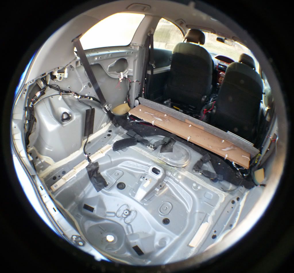

I'll be using eDead 45mil deadener and using two layers on the areas you can see for a 90mil thick finish. Ill put a little bit on the actual panels themselves. Might do an extra layer or two over the wheel wells and the muffler spot.
Definitely not going as crazy as sqcomp but hopefully this will quiet it down.
Once this is all done ill be making the frame for the new deck which on its underside will have a couple layers of eDead as well.
Eventually Ill order more and do the doors and foot wells.

welcome to the GOOD side... sound dampening is about the coolest thing you can do to a car.
what is your goal? reduce road noise, or reduce rattles due to the sub?
If its reduce road noise, put it all on your wheel wells, firewall, and floorboards. if its for rattles.... don't touch any of those places and put it everywhere else, especially the trunk/hatch area.

Yea its going to be for road noise for sure....it's pretty bad.
I've got 100sqft coming tomorrow and I've got all allotted for the back end of the yaris.
Ill do 3-4 layers on the wheel wells and 2 everywhere else and see how we're doing.
The deck will also absorb a lot of noise.

another weak spot for noise is the floor board right behind the front seats (foot area for rear passengers)... I actually ended up going 3 layers deep there.
I only went 1-2 layers on the wheels.. with a layer of foam... wish I would've done more like 2-3... they seemed very rigid... but sound still comes through that part.
I too had a bad experience with edead.... though that was back 5-6 years ago. The owner used to be a standup guy... but then he kinda started cutting corners ... not sure if he ever got his game back on track.... i've been too scared to try eD out ever since.

and so it begins, off to freeze in the hatch of an empty yaris....with a heat gun and hand tools.

And all the cut out pieces for the wheel wells.

i'm surprised you took the time to cut out pieces... I just cut chunks off... and slap them right on... make sure there are no air bubbles... and continue.

yea i was scoring the stuff a lot to get the bubbles out, i got the wheel wells and the side panels behind the rear speakers done, everything had no less than 3 layers.
Man am I tired and freezing.
