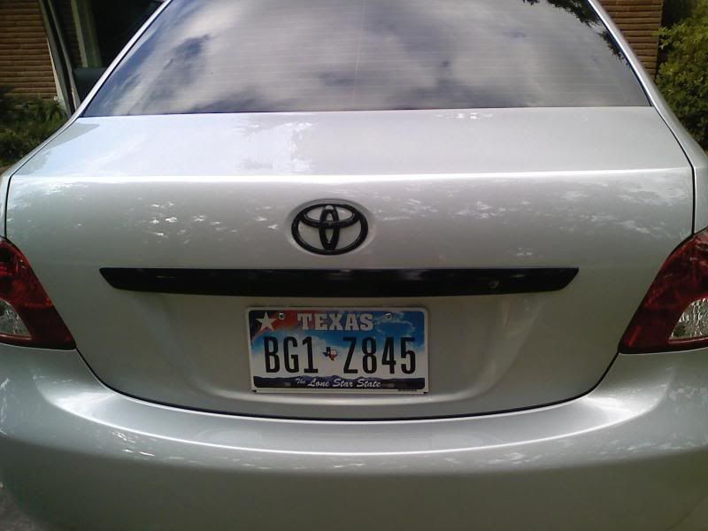

painted mine myself
btw love your sig op makes me miss my old mk3
HAA HAA .... dangly parts

thats the best pic I have
yeah im probly gonna color match mine when I get my dents and dings touched up
