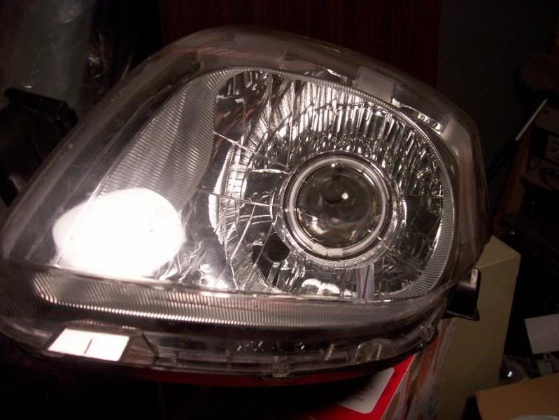

got some time this afternoon while my daughter was napping in the car....finally put in one of the projector lenses in the oem yaris housing
went together relatively easy....

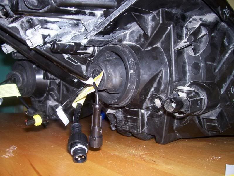

How did you get them to sit "flush" towards the back of the housing? They look really good.

Hey Adam, is that the bolt-on projector kit? If so, I think you may have installed it incorrectly. The cut-off is going to be vertical instead of horizontal. I'm thinking this because of where the LED's for the halo is located. They should be at the bottom of the ring, but in your picture, they are facing to the left of the headlight.
Old 11-17-2010, 10:10 AM   #10
the bottom of the halo ring is pointing down
i actually installed them upside down to begin with just from taking the projector apart to look at it....
what i am doing to check the beam direction is shining an led flashlight i have thru the back of the lense....so its set up correctly, trust me.
you just have the orientation of the headlight wrong in your mind. the bottom of the headlight is the bottom left of the pic....

My bad. lol, explained on MI. hahahaha. That angle just makes it look like a sedan headlight or a LB headlight laying on its side.

test fit the new projectors today
time to seal them up now....both work

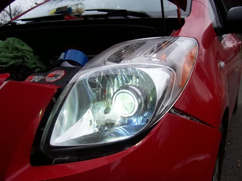

good job, are they a marked improvement over the stock light with better bulbs? how long did the whole job take you. do you sell and do the work.

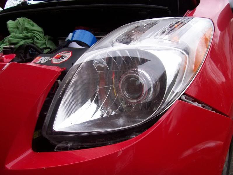

ok, got a second wind tonight after a pb&j, so i sealed the lights up.....went together much easier than i expected.....the lenses just popped back into the clips without issue....i really though i was going to have to bungee cord the backs and fronts together.

Nice. Did you have to dremel the inside of the housing for the projector to fit?
Old 11-23-2010, 08:00 AM   #17
yes.
i had to cut off all of the brackets that normally hold the H4 bulb and bore out the hole a bit to fit the projector
