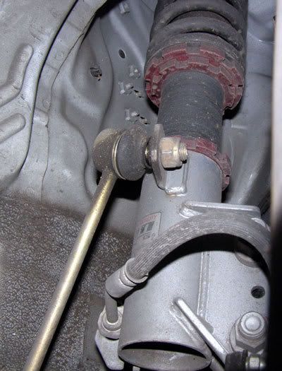

where do you have your height set on the spindle and how does the drop look?
i was talking w/ mojoyaris yesterday about this and am subsequently thinking about running w/ the rears all teh way up and the fronts about 2 fingerwidths from the top....
can anybody lend some experience on this?

My rears are almost all the way up; I'd say there are only a few threads left. The fronts have a lot of threads left still. I wish I could raise my back end up a bit, actually.
Here's how my car sits right now in "winter mode" w/steelies, and in "summer mode" w/orange wheels and 195/55/15 tires.

they seem like they can go pretty effin low....i mean thirty-nine has the rears almost all the way up and is at least -1.5"....and check out the thread left to go down on the rears....theres a TON left
the fronts seem to be similar.....talking w/ mojoyaris, he says he has about 2 finger widths to the top and his drop looks similar to 39
so really i think you can slam it low low on megans...if you want to

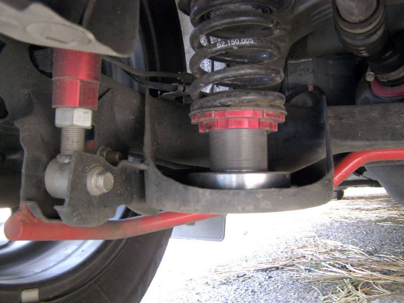

Could someone tell me what the big silver bolt with threads right under the rear red shock body is used for and if it needs to be adjusted at all coming right out of the box? Would I be able to go as low as 39 in the pics if I dont adjust that bolt and only adjust the springs?
used to adjust preload on the rear spring
Bubbles is offline   Reply With Quote

Posts: 110
And how does that work, how do you do it?

Posts: 19
Between the adjustment on the perch below the spring and the one on the shock you can change the preload on the spring. If you were to put the spring up all the way and the shock down the shock can only extend so far and it will put more load on the spring.

Posts: 110
I sort of understand now, so what would be the best setup? If you lower the spring, dont you have to lower the shock as well, and vice versa when you raise the spring you raise the shock for best results or am I mistaken?
