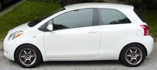

OK last check. I found an incredible deal on 15x6.5" Nippon wheels with 205-50-15 tires. I found an anynomous white Yaris and photoshopped these wheels on. I am almost 40 so wanted to go with more conservatice OEM wheels but what do you think about these? Too crazy for an old man? Main reason for the new wheels is for better handling (also adding a TRD suspension.)

The white Yaris with the 205 50 15 is perfect, the rims a good stlyle for the car.
