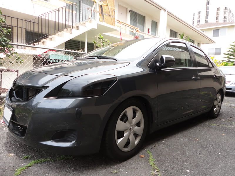

Morning shot of my baby in front of Garage Js4Kix here in Honolulu

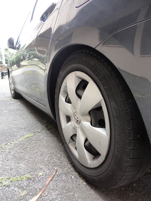

Wheel gaps

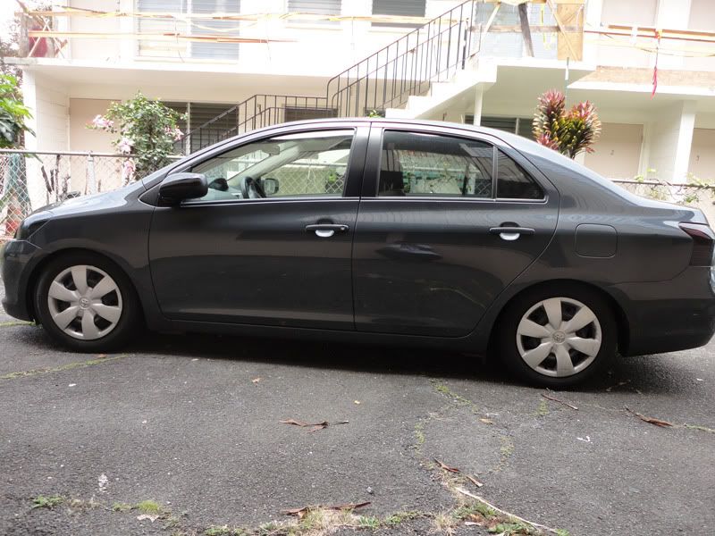

Here goes. I have at least another 1.5 inches to go down. Right now I have it at a height to where I can get out of my driveway safely. There is camber now in the front which makes it interesting to turn when the road is wet.
Full sound deadening next week. XXR rims coming next month.
