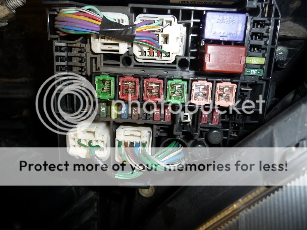

So I whipped out the multimeter and with the engine running it only has 11.8V across the battery (12.6V with engine off). This lead me to assume that either the alternator is toast or a fuse is blown. So I pulled off the fuse box lid and have worked out that there seem to be two fuses missing, I think.
So can anyone tell me if the following two fuses are needed:
-7.5a "Alt-S" (this seems to be a likely culprit)
-40a "Main2" (this also seems like it should be required?)
I found this pic:
http://i270.photobucket.com/albums/j...r/IMG_0601.jpg
The fuses I am talking about are the right hand brown 7.5a fuse on the bottom row and the missing large fuse on the same row 3 fuses to the right
Edit it is also missing the 10A fuse bottom right next to the two big plugs, "EFI2" I think it is

Ok here is a pic of my fuse box, from google it seems most dont have the large 40a "MAIN2" fuse but do have my missing 7.5a and 10a fuse?
http://i566.photobucket.com/albums/s...ps3775b71f.jpg
Sorry I cant refer to my owner manual or anything as they are in Japanese and you can only gather so much info from the pictures, so if someone could please check their fuse box for these fuses then that would be great!

I have the paper wiring diagrams for the Vitz.
The ALT-S fuse should be there and is the feedback to the voltage regulator in the alternator. If that is not present the alternator will not output.
The 40A MAIN2 or 30A MAIN2 are only used in certain configurations of the Vitz. It looks like the 40A one is used to feed and auxiliary heater and the 30A is used with some headlight configuration (probably the HIDs).
The EFI-2 fuse does not appear to be used (nor have I seen it used in US or European Yaris).

Thanks so much! I have no idea why it has been removed but I will buy a new fuse afterwork and give it a go.
I had a thought last night in bed that the 40A main might be for driving lights or HID and it must be the ALT-S one causing me issues as if a EFI fuse wasnt there then surely a fuel related thing wouldnt work.
