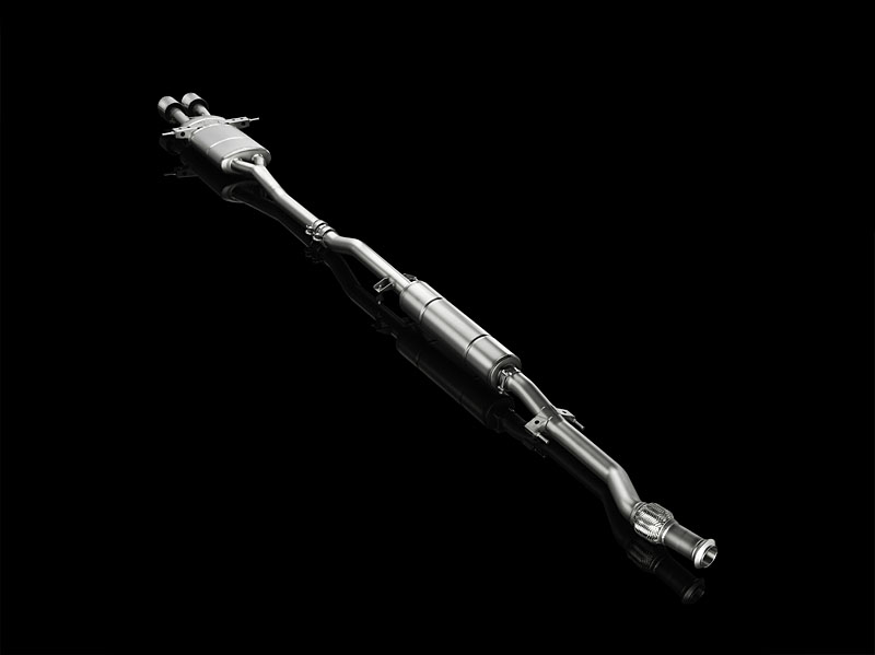

This is the design of the Akrapovic exhaust for the MINI. Will two U bends be overkill? This attaches to the DP, so I'll also need a flex pipe. No resonator in the middle. Feedback appreciated.

what are the U bends for? that is such a straight down the middle setup i dont see how just cutting and welding a slight angle would not suffice?

That's actually a valid point...the bends would have been to cut out the angles, but you're right, with how straight it is, cutting a straight pipe at an angle would probably be easier, and cheaper...

not to mention a good clean weld should provide similar flow. Or if you have it mandrel or crush bent, they can make thos slight angles all out of 1 pipe

That looks like it would be more easily achieved with just a couple mild mandrel bends (hopefully your guy is equipped with one).

I don't have a mandrel bender at my disposal, unfortunately, going to just be doing an easy fab job. This is really only for better sound, and a bit more power for auto cross, as I will be trading the car in as soon as I can order a '15 Countryman All4.

Looks like most of us agree that just bending the pipe is your best bet

I'm not 100% on the crush bending. Worst case, I'll just cut the angle. With the people that will be doing this work with me, I'm really not too concerned, and confident it'll turn out great (two master welders, one builds custom parts for bikes). I'll be sure to snap some pics as we work and get them posted, as well as some before/after exhaust audio clips.
