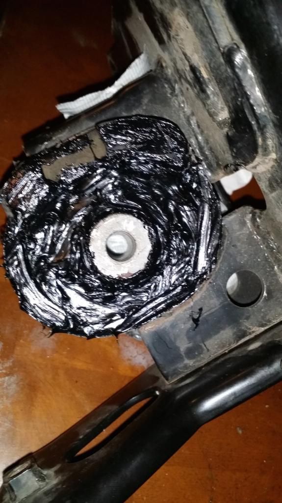

I filled my engine mounts with 3m urethane lol The engine moves but not a lot like when it have the oem mounts. Also there is a little vibration when the car is at idle. For 30 bucks I think is the best you can do. lol

I fill the transmission mount and the back mount also. I have some pictures of the entire process. I post them later.

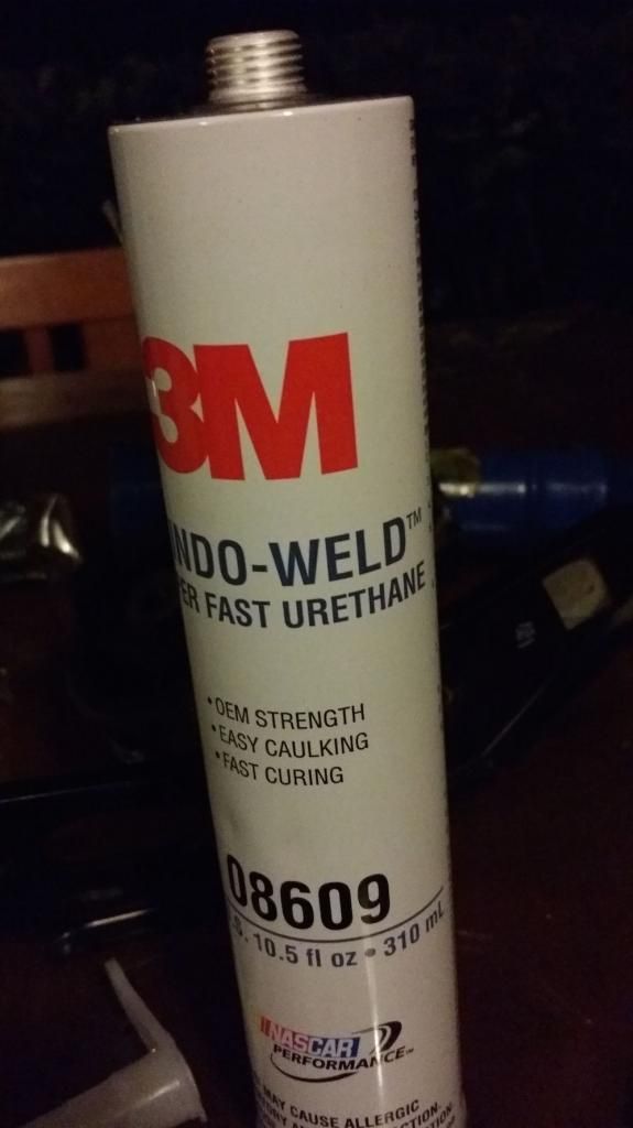

Sorry for the delay.
This is the urethane that I used.

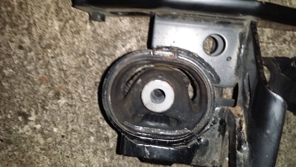

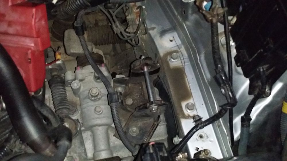

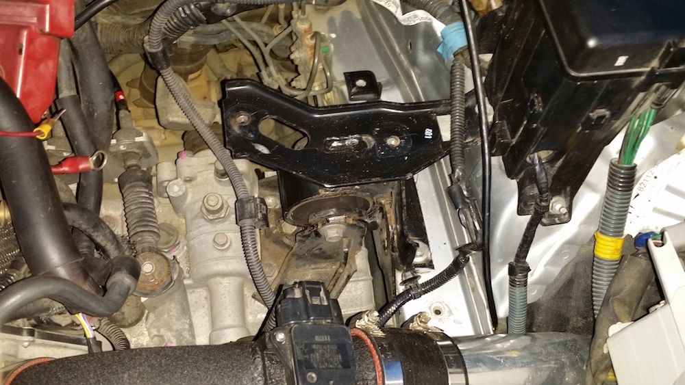

To remove the transmission mount you need to remove the battery and the battery bracket. It's easy to remove. You need to put a jack stand to hold the engine and then remove the mount. To remove the back engine mount you don't need a jack stand.
Before
After
I don't have pictures of the back engine mount but it's much easier to remove that the transmission one. Also you need to let the urethane cure 24 hours.
