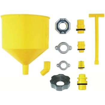

I have personally never found the 1nz to he hard to burn if you have the front jacked up, I just over fill the overflow reservoir when I'm re filling an empty system and after driving around a bit it will burp itself and pull from the overflow.
But as Barber stated, the funnel allows you to do it all in one shot in your driveway and is a convenient tool

I'd get a spill free funnel kit and burp the system properly.
Put funnel on and fill halfway. Start car and idle it for 10-15min and watch bubbles leave system. Even squish upper rad hose on occasion to get air out.
Old 08-28-2018, 08:56 AM   #15
