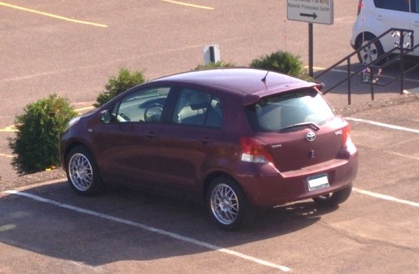

Just an update. I recently had the wheels and tires installed on my Yaris.
The reduced offset allowed the wheels to push out just shy of being flush with the fenders, which I think look pretty nice. I really didn't notice one side sticking out further than the other in front.
I did immediately notice a difference in handling with the car taking the corners better and with less of a sloppy feeling I had with the stock Bridgestones. That may be due to the new tires, wider tires, or some combination of both. With the newfound grip, I did then notice the body roll so I guess the next mod is the rear TRD sway bar and perhaps some new shocks/struts.
I did notice my mileage take a slight hit, likely due to the wheels and tires being a little bit heavier than the stock 15" steels. So far, no issues noted at full-lock turns, speed bumps, hard cornering, etc. Overall, I'm pretty pleased with the new shoes.
