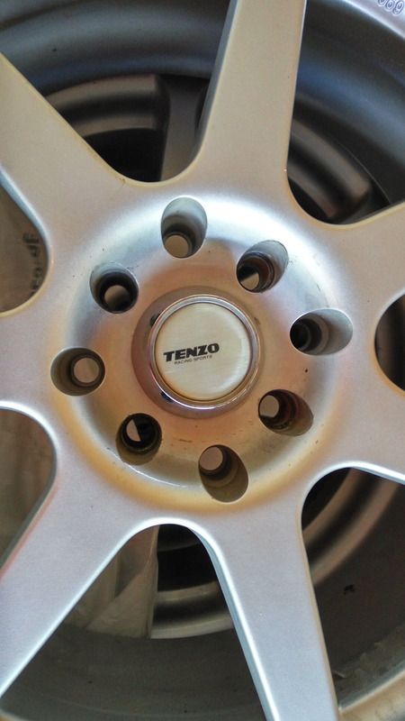

make and pic of ur new wheels would help

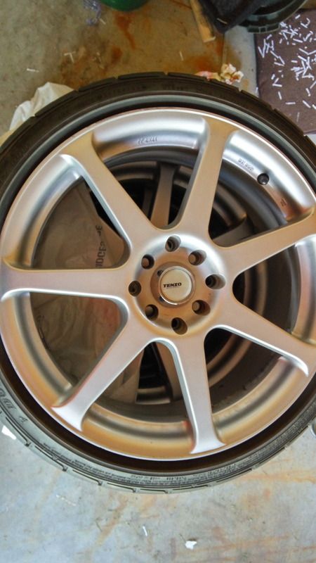

They were sold to me as Tenzo' not sure if they are.
They're 17x7 ET42
Here's a pic.
ebaut is offline   Reply With Quote

You just need tuner lugs, possibly the once with allenkey style or spline.
Plus what is the hub bore Yaris is 54.1 so Ull need hub rings.

I use the black spline but for ur application the silver in pic should work.

Measure the diameter of the smallest part of the opening (to see if the 0.62" diameter tube of the Gorilla lug nuts will enter.
Also, measure the depth from the beginning of the taper to the back side of the lug nut opening. From the picture it looks like they are really thick wheels, which would mean longer studs would need to be installed on the car.

That would be the issue from ur pics u probably only can fit the silver once...not much space there.
I just measured the opening at its smallest part, i actually measured from the back, i got approximately 13mm or .52"
I think I might be screwed.
