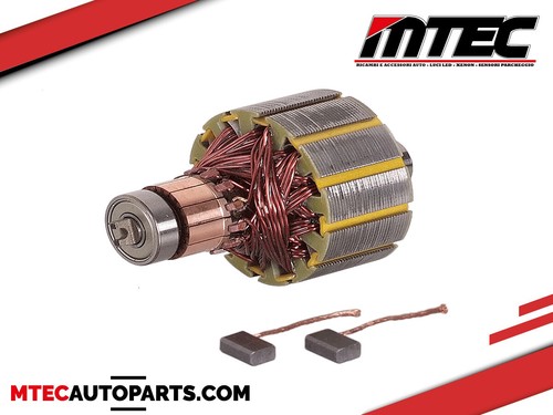

Okay I took out the ABS1/VSC1 fuse from under hood fuse box. No sound but of course the ABS light went on. When I put the fuse back in and started it again, the light stayed on until it made the buzzing sound. Then it went off so it's definitely the ABS motor. I think the brushes may be worn. There's kits available to rebuild just the motor. Has anyone here ever done this?
https://www.ebay.com/itm/38201439033...mis&media=COPY
