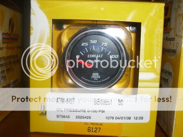

*My gauges came in today! YEEEE. Don't know when I'll get to install them though...
