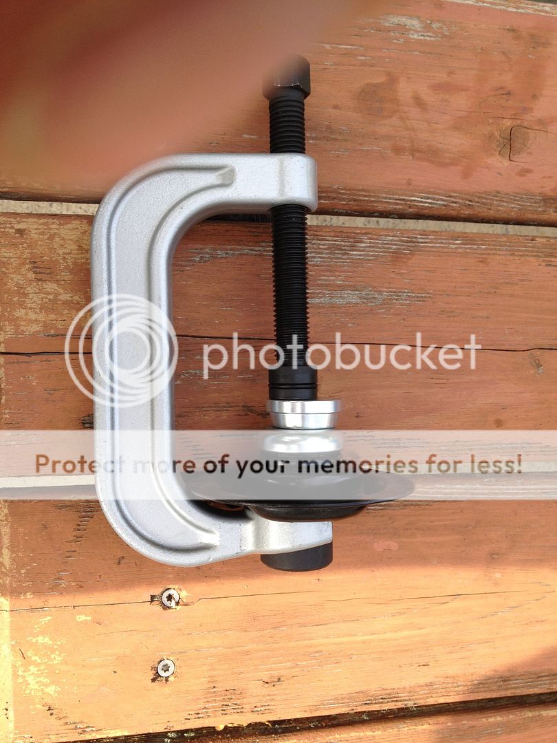

I tried a rubber mallet and a otc bearing and race set but couldn't get bearing to go in. BINGO! Alltrade bushing tool w/ OTC bearing and race disc as the driver.
