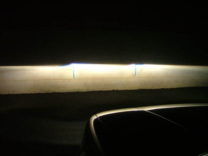

You can set it up like this where the driver and passenger side cut off's stack (has two "steps"):
Or the conventional overlapping way (has one "step"):
