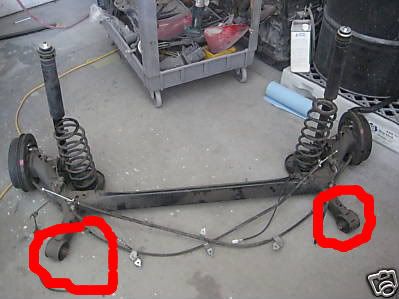

turboyaris is making some bushings for the rear torsion beam.
aluminum rear bushing:
I believe they go where I circled

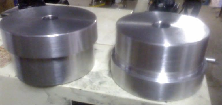

yeah, i knew turboyaris was making those aluminum bushings, so that's cool. but then there's all the rest of the rubber pieces of crap that should be replaced with urethane. i would think that these would have gotten more attention?
you'd be suprised at the difficulty to get bushings made in urethane, there are only a handful of companys that will do custom urethane bushings for you. I only found one actually that will do a small run of automotive type urethane bushings, not to mention that to make it cost effective, you need to spend a decent amount of money to buy them in a larger quantity. the process first is to replicate them in aluminum or some other material, test fit them, and once you get the proper dimensions, have a negative made so that the company can just pour the urethane in and seal it up.
the outer ring is for overflow purposes.
If I couldn't make that mold, the company would charge me $250 just to make that. Plus, just to pour the urethane is pretty expensive.
If it were just making aluminum bushings, it'd be much easier for me. I am starting with the axle beam bushings, and if they are successful, I will start on some other bushings, probably doing group buys, so my up front cost isn't as high.

hmm delrin... interesting, I hadn't looked at that before, it is a little more cost effective but requires more of my time, it'd be interesting to see how easy it is to machine, I read the machining properties of it, and it doesn't sound too bad. The pieces are made from 3" aluminum rod, I don't remember the exact dimensions, but its something like 1.7" long and 2.6" or so
