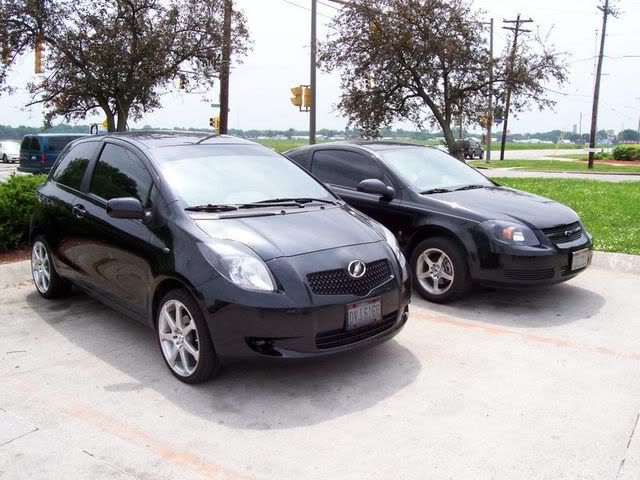

my car 17's not lowered
in black
in silver
15's also not lowered
Old 06-21-2007, 10:53 PM   #11
Black Yaris
der Zeck
Black Yaris's Avatar
Location: Toledo, OH
Posts: 5,231
BTW, the cobalt in the above pic has the 15's on it from the 3rd pic

what size of tires do you have on your 17's and 15's? What are the wheel sizes and offsets? To me both the 17's and 15's look nice! I was also looking at the Polo Spy 17's, but I couldn't find anywhere online what the offset is for them or even if they have the right bolt pattern.

Hey Black Yaris, what's with the black then silver 17's on your car in the pics?
Did you paint your wheels black?
Old 06-21-2007, 11:06 PM   #16
yarischester
Drives: Silver Yaris Sedan
Posts: 10
The black and silver wheels are the same wheels on the black yaris?

black yaris - What kind of wheels are those 17's? They look much better than the stock wheels on my yaris sedan. Do they have those in silver 15's or 16's?
