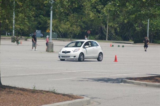

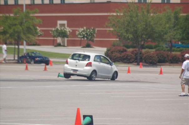

Finally got some autox pics:
it looks like it could use alot more spring all the way around.

very nice! the front could do with some stiffer springs IMO. i LOVE my new setup, just needs to be a bit lower.

i was thinking, i could almost even get away with the front sway bar upgrade instead since im running such high rear rates.

that's a band-aid and will slow you down as it will lift the inside tire causing wheelspin :(

yeah, i think i agree... I think i need some sleeves and springs really. but if i do that, i want stiffer rear springs. i think my ideal set up would be 300 lbs F, 400 lb R. Im considering the perch on the rear shock idea. Would you do it if i sent them down?

perch on the rear shock isn't recommended. the wall thickness is not thick enough i think. maybe look into shocks from teh rear of an accord?

jesus thats some air you are catching =)
