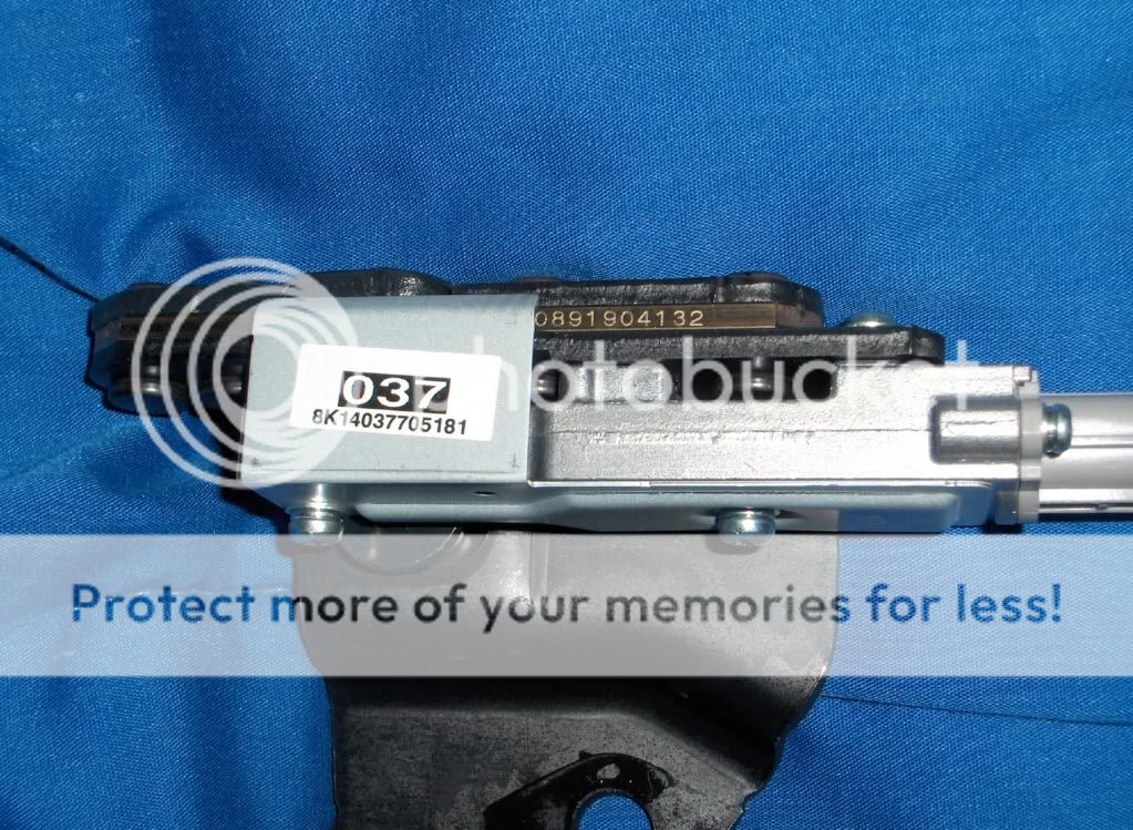

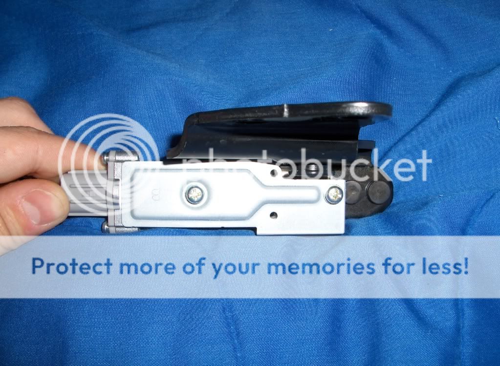

Since you have them off of the seats now, let's see some pics of all sides of one.

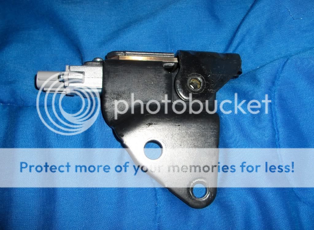

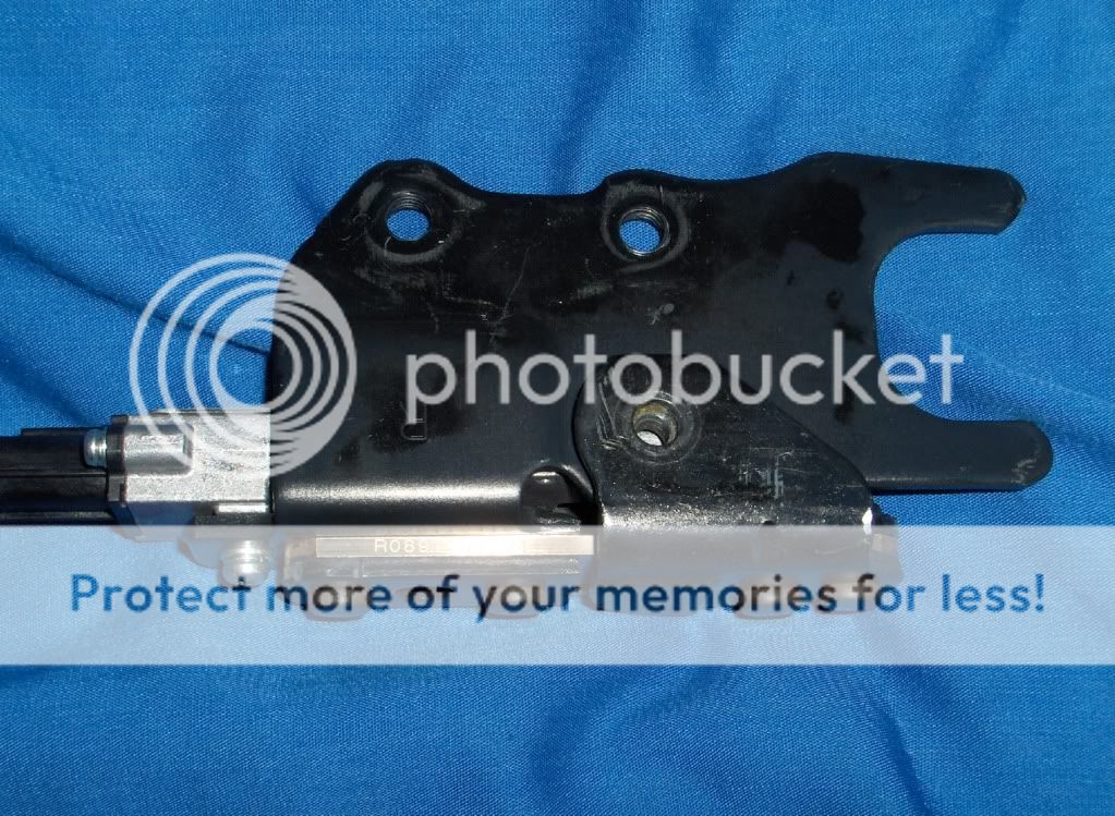

This is #61- right side rear sensor:

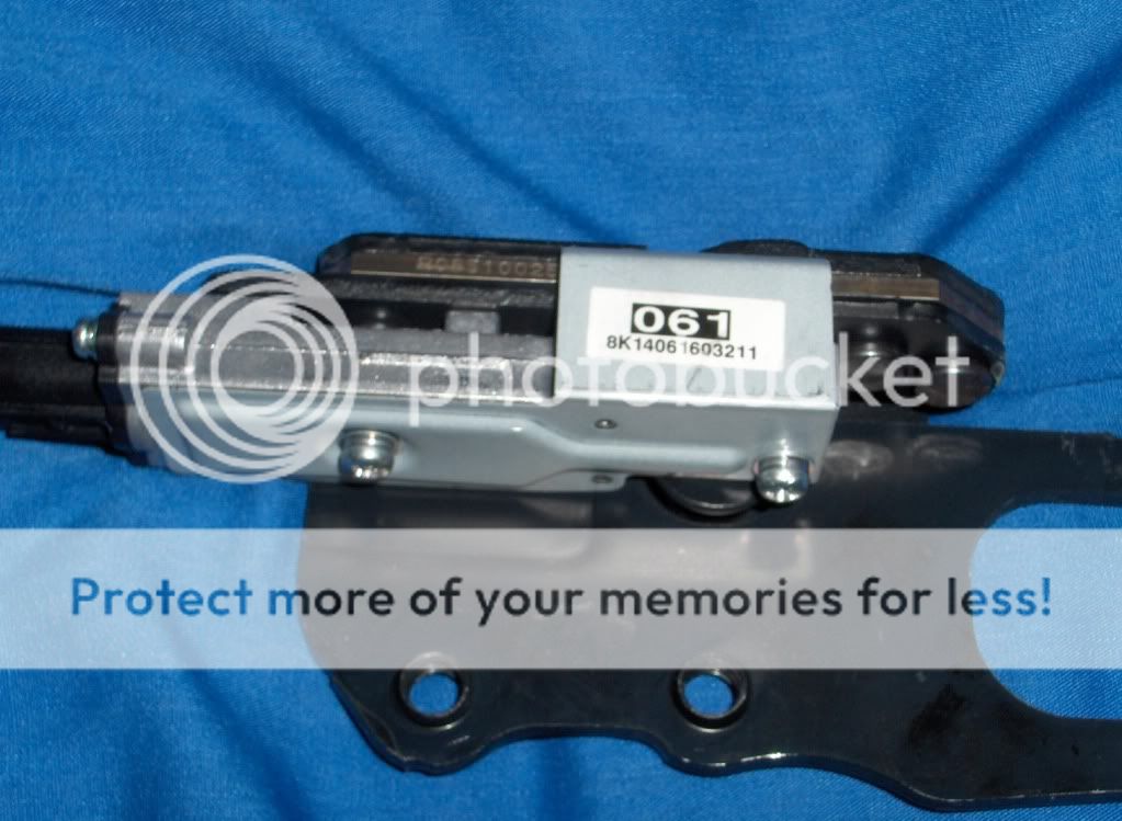

...and this is the right side front, #037:

Those senors are connected to those black brackets by two screws and this...:

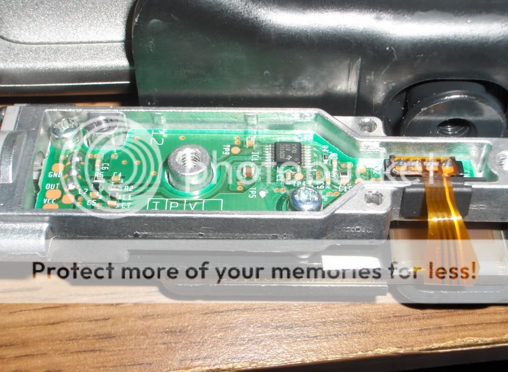

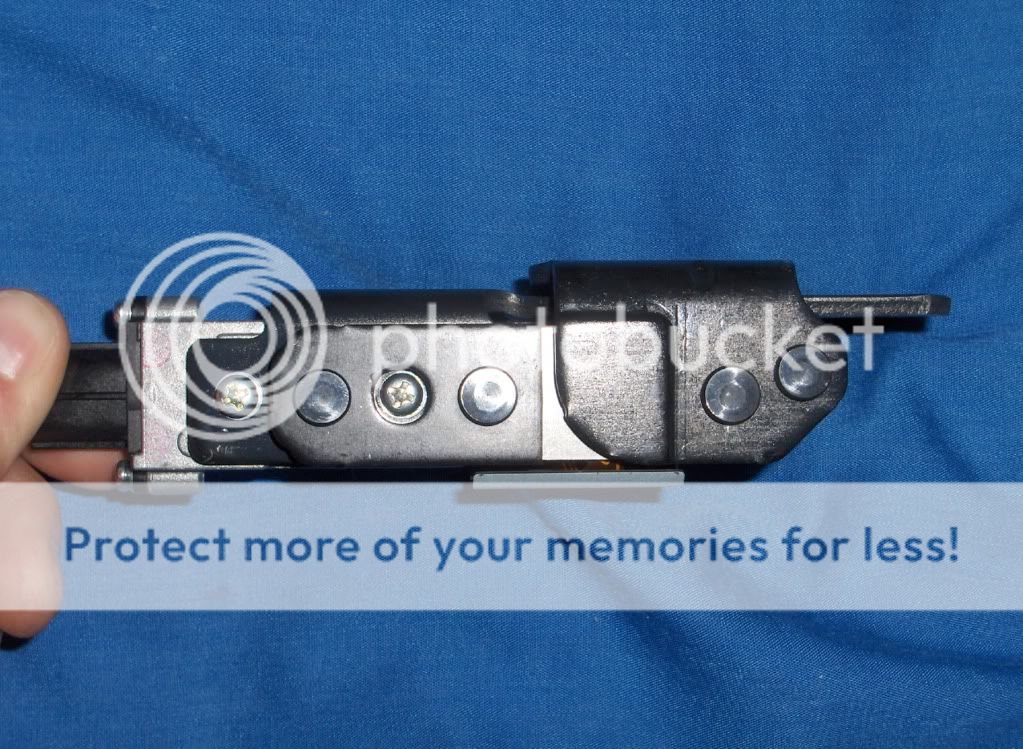

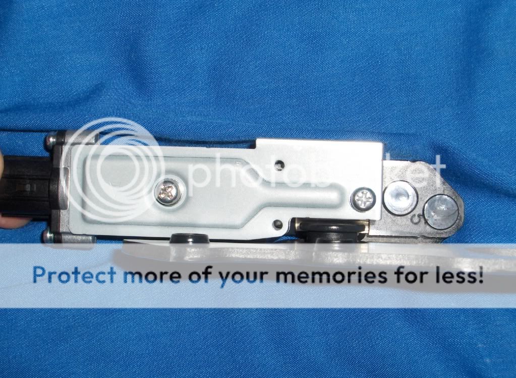

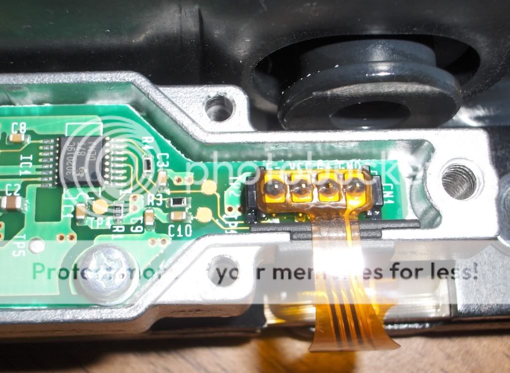

Some close-ups of the sensor with it's clothes off:

Wow, they really didn't design them to be easily transferred to other seats.
Old 08-09-2009, 10:28 PM   #170
MGargano
Drives: 2009 Yaris Hatchback
Location: NJ
Posts: 792
They sure didn't; especially considering how the rear brackets are designed. Without the rear sensors and their brackets, the OEM seat and bracket/rail can't be held together. The rear sensor/bracket is the only piece with threaded holes, holding the whole thing together. So the seat depends on the sensors and vice versa. With all four sensors out, there's nothing holding the bracket to the bottom of the seat.

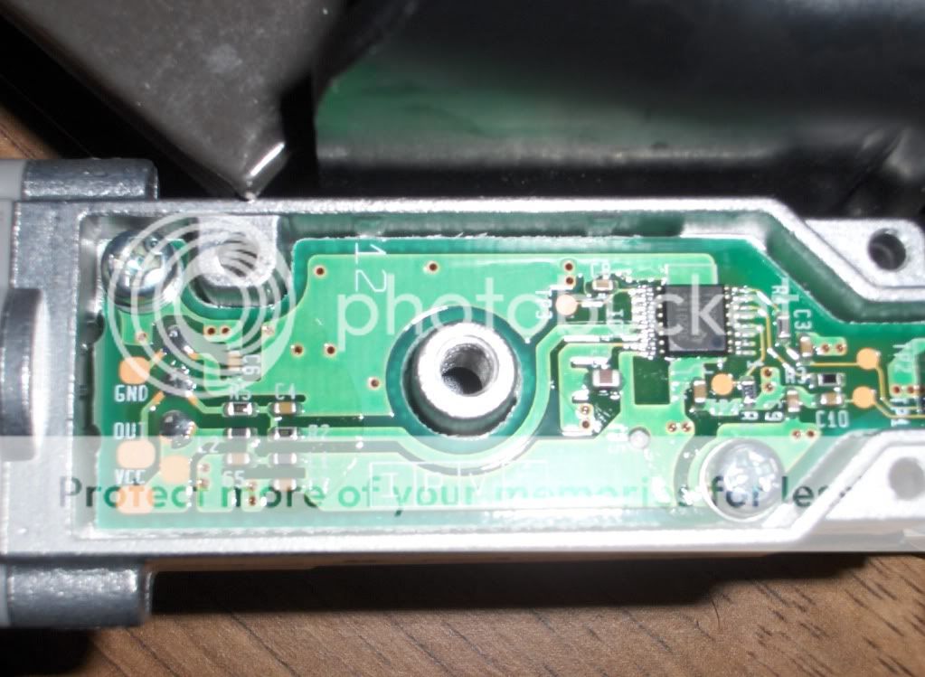

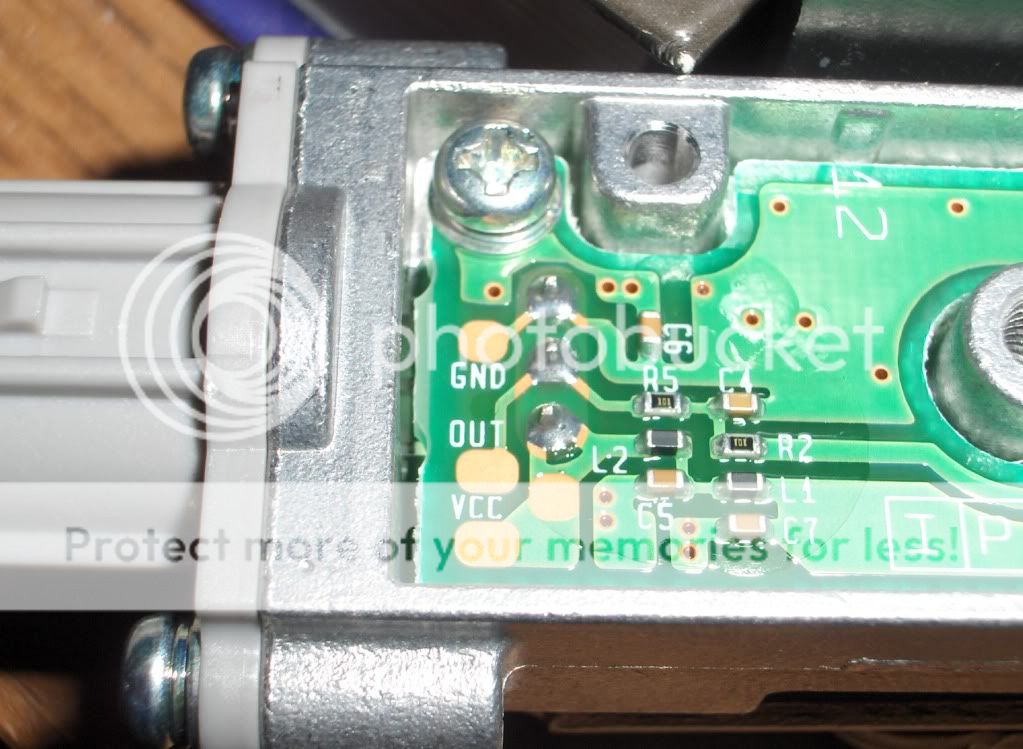

To test the voltage going to the sensors, can't I touch the red lead of the multimeter to the silver rivets (?) near the GND, OUT, VCC?
MGargano is offline   Reply With Quote
Old 08-11-2009, 08:02 PM   #179
MGargano
Location: NJ
Posts: 792
Old 08-11-2009, 08:41 PM   #180
Posts: 13,460
Now that you have the cover off you sure can. You can hold the black lead on the head of that phillips head screw (which is connected to ground) and touch the red to VCC and OUT.
Just be mighty careful not to touch two at the same time.
