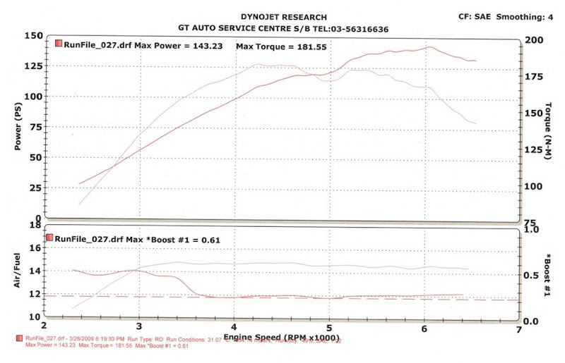

just want to share the dyno chart with everyone here.

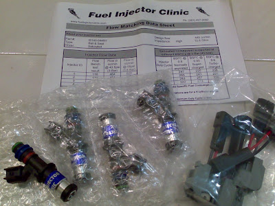

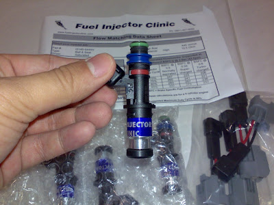

The FIC injectors cleared customs yesterday and arrived this afternoon while I was away in the office.
Together with the forged internals when they arrive, we should able to make some serious power when we crank up the boost.

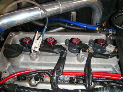

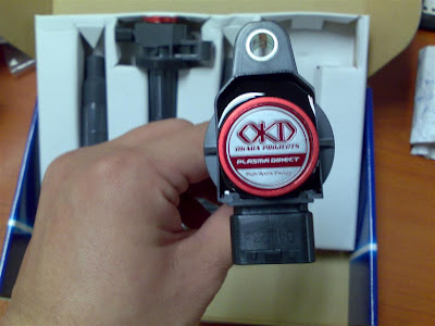

Dyno Results for Okada Projects Coils
The dyno results for the Okada Projects Plasma Direct coils is finally out, the results are more than what we expected as the dyno machine was able to pick up the gains both in horsepower and torque.
It took us less than 10 minutes to swap the coils and we took this opportunity to throw in a new set of plugs.
Autolite Iridium plugs
We did a base run and the car pulled 143.34 PS and 18.53 kg-m of torque at the wheels. With the Okada Projects coils fitted in, it gave us 153.01 PS and 19.45 kg-m of torque.
Blue: Without Okada coils
Red: With Okada coils
A first glance at the dyno chart it seems like the overall gains is not so impressive as we only gained around 9.67 PS and 0.92 kg-m of torque.
However we noticed that the gains are available throughout the entire powerband starting from 3,000 RPM all the way to the redline.
What caught us by surprise was not only the torque curve has been flatten, there is a peak gain of 14.22 PS and 2.02 kg-m of torque nearing the 5,000 RPM range.
In the past, the original coils simply just couldn't maintain sparks that were strong enough at the high RPM range to achieve a flatter torque curve. Seems like the Okada coils were able to get the job done.
Peak gain of 2.02 kg-m torque
Peak gain of 14.22 PS
Overall I'm quite impressed with the Okada coils, and would certainly recommend it to anyone whose interested in it. However, you would still need to find a good tuner who knows how to tune your car properly in order to enjoy the gains.
Besides the gain in power, the coils could also serve as a nice dressing item in your engine bay as well.
