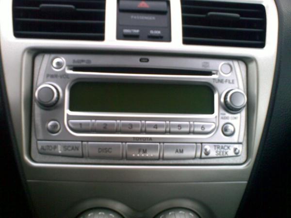

It looks basically like the one you posted, but all silver. As seen in the somewhat blurry cellphone pic:

Posts: 3,888
weird.. this unit looks butt ugly on a sedan :P It's easier on the eye with the black HU. but this confirms my thoughts... The radio is dealer installed. That's why we all have all those different kind of radios.
anyways. back to topic... definitely not AUX capable with yours. If it was somehow aux capable, you would have an AUX button on the unit.

Heyyy.. I kinda like the silver :) Fits in nice with the rest of the trim.
I know it doesn't have the AUX button on the front, but I was hoping the stereo might still have the parts inside to use the function if it was activated somehow. I was thinking of something similar to how the stereo recognizes the 6 CD changer and functions by pressing DISC multiple times.

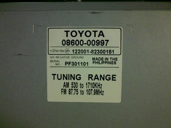

Very interesting thread. I have fujitsu 08600-00997 cd stereo, with D74 aux connector at the back, and there is a jack plugged in with all the wires connected to the pins used by aux input (17,15,16,19) according to the manual.
The problem is that I can't trace the cable, and there is no aux jack next to emergency brake (I popped plastic covers and there is nothing there).
Does anybody know if this model actually supports aux input (no buttons on front panel)
sergo is offline   Reply With Quote

Originally Posted by sergo View Post
Hi guys
Sergo, can you please post a picture of your D74 aux connector, so I can see the collors of wires? pls
