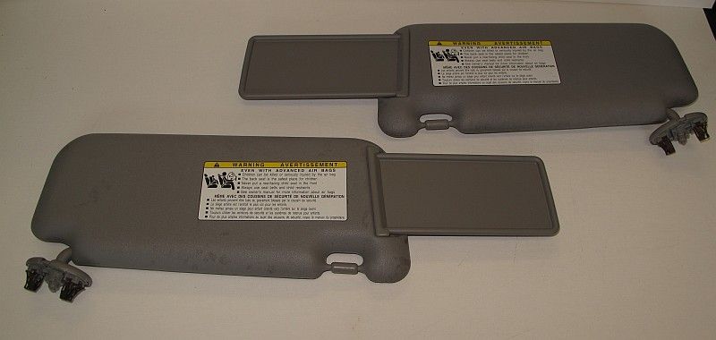

I just picked up a perfect set of visors with the extenders today. I was grabbing some connectors from a local junk yard and figured someone could use them.
$45 shipped

Got mine from eBay today. Not happy with them. The seller said they were in good condition, but these have plastic "stress marks" (like when you bend a piece of plastic and it turns white) around the edges of the openings for the extensions. One of the extensions is loose and slides in and out almost freely. There are also scratches on the oval parts that pop into the roof.
What should I do?

Anyone have a step-by-step of how to remove the stock sun-visors? I tried taking mine out, but was afraid I was gonna break something.
Old 10-29-2009, 08:57 AM   #36
Posts: 13,460
1. Swing the visor out about 45 degrees.
2. Gently pry off the mounting cover
3. Rock the visor up and down while pulling on the mount
It takes a bit of elbow grease to pop the clips, but that's how the service manual says to remove them.
