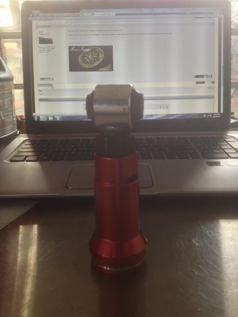

Well by that I mean like when your wheels leave the ground and then droop back down to earth, if you have the shock short enough, the shock valve tops out before the wheel touches the floor. This constant smacking of the shock valve against the top of the shock causes the o rings to pop out of place and then the fluid poors out.
Both Miles and I have had it happen where the top o ring blows, both times were set so short. You could hear the shock topping out on some bumps too.

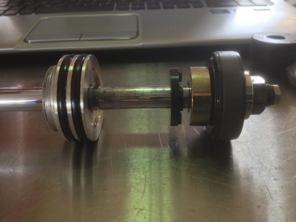

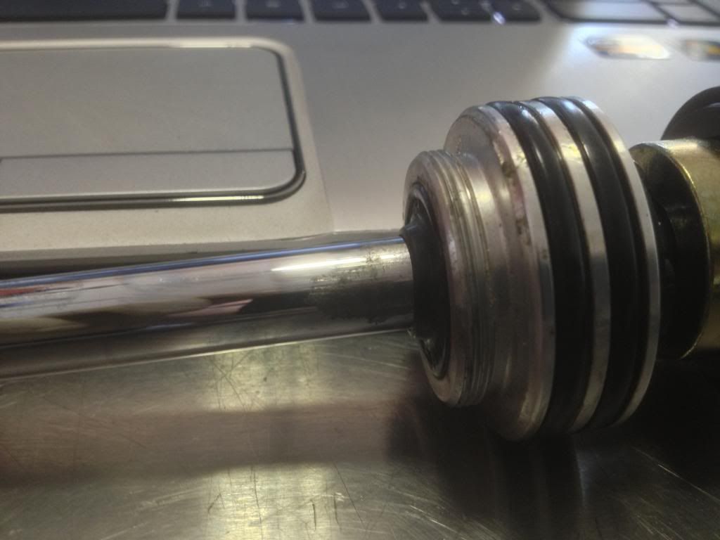

the upper seal being "shocked" by the valve stack hitting the upper cap seems very unlikely to me, the valve stack has a "shock absorber" or "bump stop" built in, between the valve stack and the top cap is a rubber disc to stop contact and dampen the movement when the shock is fully extended.
The top cap is to the left, in the center is the "bump stop" and to the right is the valve stack.
IMO the biggest problem with all the cheap coilovers is material quality, every leaking or "blown" set i have seen has had the same problem, poor quality plating on the shafts. the chrome comes off and dirt gets into the top seal destroying the seal and letting all the oil leak out every time the shock is extended. this particular megan shock has fairly low miles on it, 15,000 ish. the chrome flaked off the shaft and that was the end of it.

Wow detective Seth lol awesome cross section view!
That makes sense as well. I guess it can be a number of things happening that could cause leaking and blown struts. So maybe I need to just let my shocks blow again and then rebuild them with some quality parts.
Even with that rubber bump stop, I imagine the amount of force being generated by gravity pulling down on the torsion beam and complete rear suspension, is so great that the little rubber stopper probably isn't soaking up all that force.

well the resistance from the shock itself is going to slow gravity down almost totally, if there is no pressure from the spring i dont see how they can rebound that fast. even with alot of weight on the shock the valves dont allow the oil to move that fast even set full soft.
