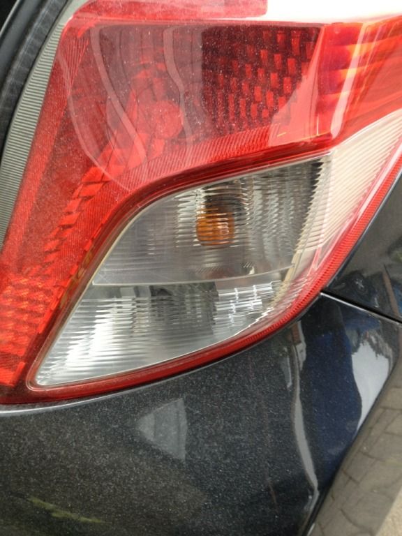

Just tried putting the LEDs in the rear and I seem to be getting hyperflash all round now. I have at the moment only load resistors at the front. One on each side. I take it I'll need them all round?
Eren_13 is offline   Reply With Quote
Old 03-26-2013, 03:02 PM   #31
Posts: 13,450
It does sound that way. The flasher relay must be setup to require the resistance of both the rear and front bulbs in parallel.

Little update and sort of an FYI - CTScott, turns out your theory was correct the whole time! I do only need one resistor on each side. I bought another pair of the same LEDs and tried those without and they work perfectly. No more fried egg effect at the back now. And they're lovely and bright. Thanks again :) I'll attach a before and after.
