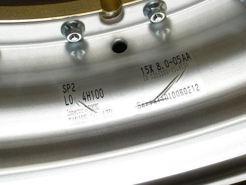

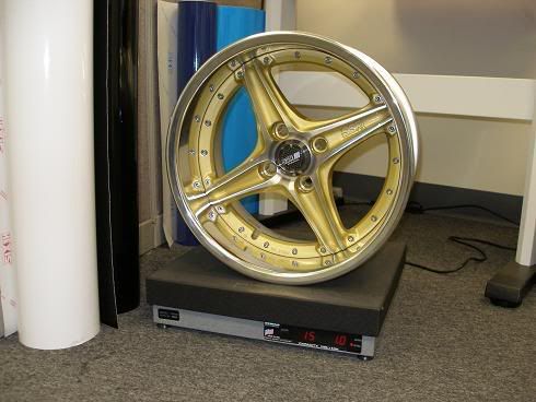

These 15X8"s came in at 15lbs so those 16"s which are probably a bit narrower should be within a pound of the 15X8 SP2's.
