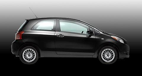

I really like the looks of these.
They say they are lightweight at 18.5lbs... for 15 inchers, isn't that a lil heavy to be considered lightweight?
The number you are trying to reach is no longer in service. Pease hang up and try your call again.
But to answer your question, yeah 18.5# is kinda heavy for a 15"

Oh, I was looking at the OZ Superleggra's FYI.

Do you mean superturimso?
They are sharp looking.

Ya, those are the ones... pretty sure I'm going to get those. They are a lil' heavy, but the price is right for the quality.
Kinda heavy? Those are heavier then my 18x10" wheels for my other car! That's also heavier then the stock steel wheels. You can find much lighter wheels for this budget without having to worry about cheap quality..
