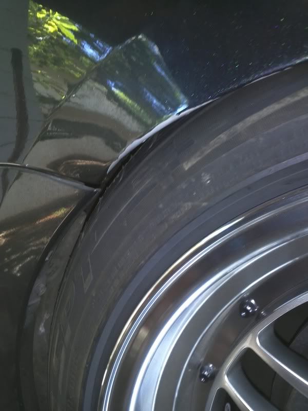

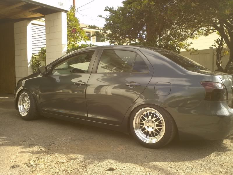

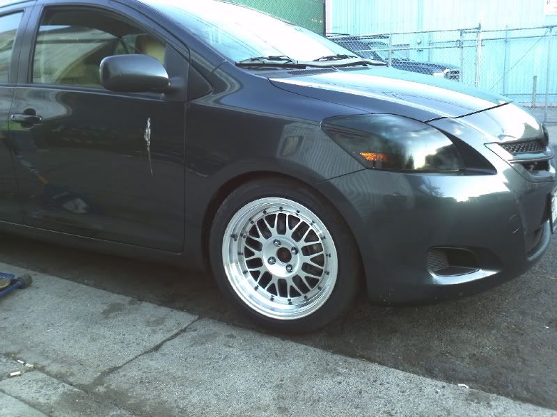

Original fitment on front, bird shit not included
(Rear)Had to use the heat gun on this part where the bumper meets the metal panel. Bent the bumper
plastic out just slightly.
(Rear)Didn't roll the fenders far down enough in , so without the roller i had to do some pounding.
(Rear)Now I have 89% full finger gap between tire and well to accomodate for travel
final, gotta get a better pic. Camera died
For the front I had to heat gun the fender liner a bit and roll some parts of the metal.
The one problem spot is where the bumper connects to the frame with a screw.
That is a fixed part of the car and cant be bended or shaped. I kind of had to do my own
reshaping there and actually took out the screw for now. Gonna just zip tie it.
The front wheels are at the most camber the Ksports allow
