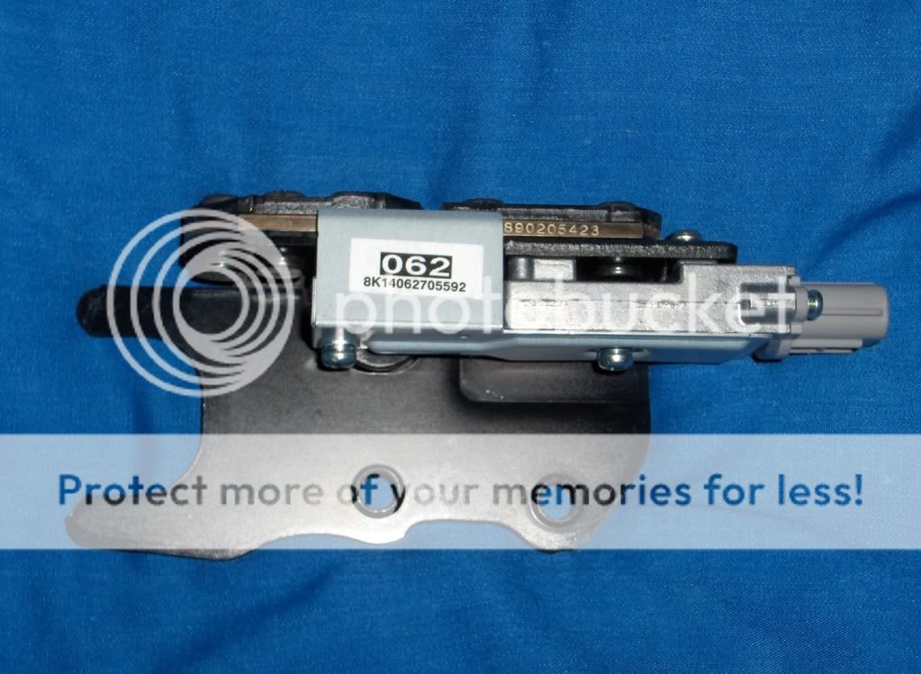

Posts: 792
CTScott... fellow forum members... meet the left rear passenger's weight sensor.

Posts: 792
...and his friend, the left front passenger's weight senor...

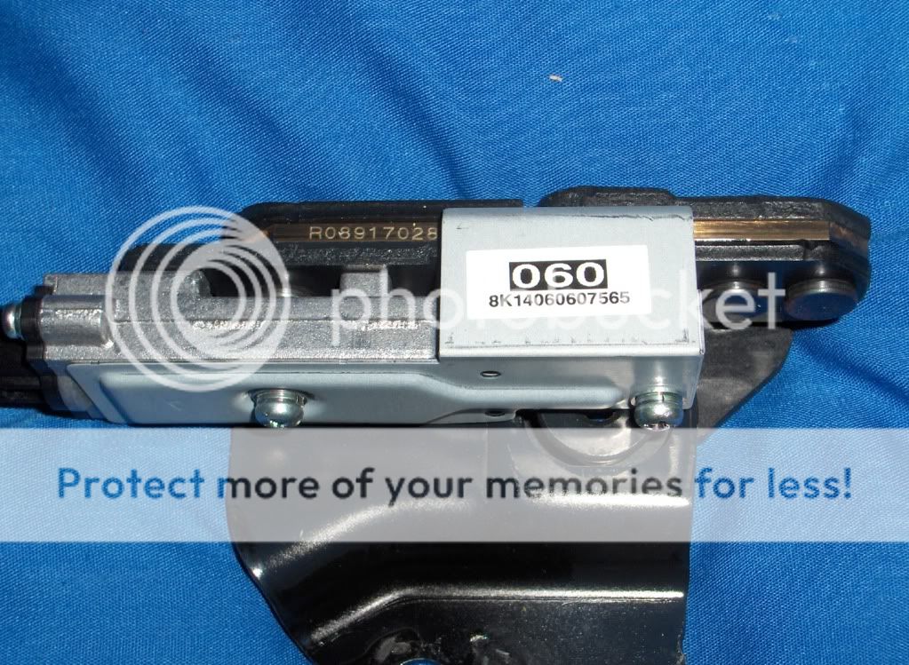

Posts: 13,460
Nice. Now the tricky part is to get the meter on with them connected. To do so, I take a sewing pin or needle and shove it into the soft rubber where the wire enters the connector. We should only need one, as we can take the measurements to ground.

Posts: 792
...and the right side front...

Posts: 792
...and last, but certainly not least, the right side rear sensor...
