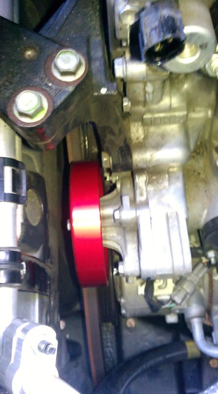

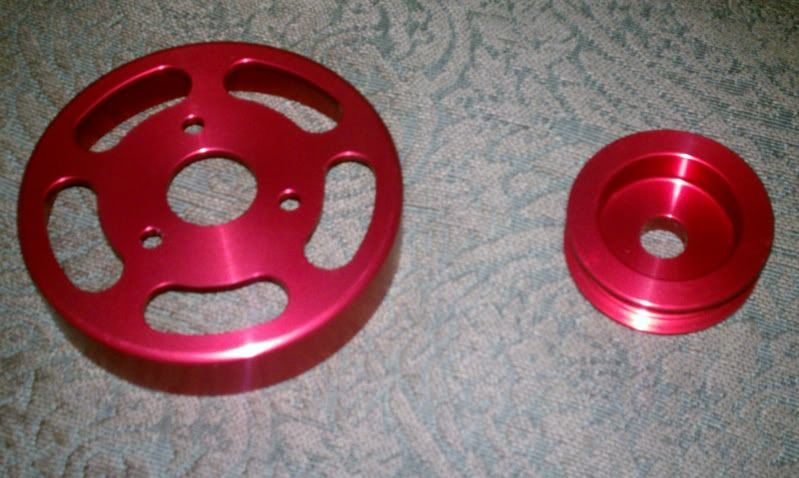

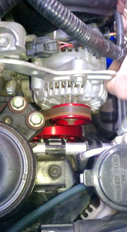

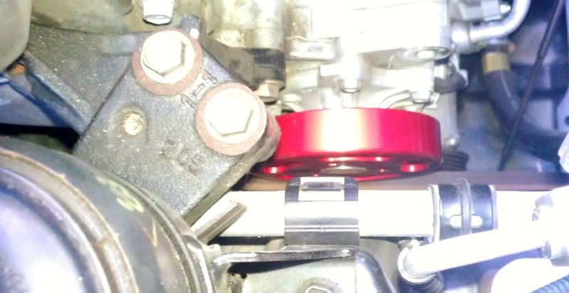

Here is pictures of the pullies,I am waiting to do the crank pully for when Garm gets his in stock.....
All in all the install took less than an hour,used an impact gun to pull the alternator pully,the waterpump pully you just use a screwdriver or in my case a socket extension and stick it in the pully holes and undo the 3 bolts.
To pull the alternator bolt holding it to the motor you have to undo the fastner screw for the AC line and move it slightly out of the way to get bolt out to pull alternator.Used 22mm impact socket and impact gun to pull pully,it once the nut is off just pulls off with your hand,no puller needed.
LIke I said I think just sheer dumb luck I blew the fuse,going to pull the aftermarket terminal and put stock on back on and get a ring for the 0/1 amp wire and mount it to the stock terminal.Pully install on a scale of 1-10 I would say is a 3 tops,very easy to do as long as you have a buddy with an impact gun.Another option would be a 22mm offset box wrench and then hold the shaft with think it was 12mm and it also will come right off.

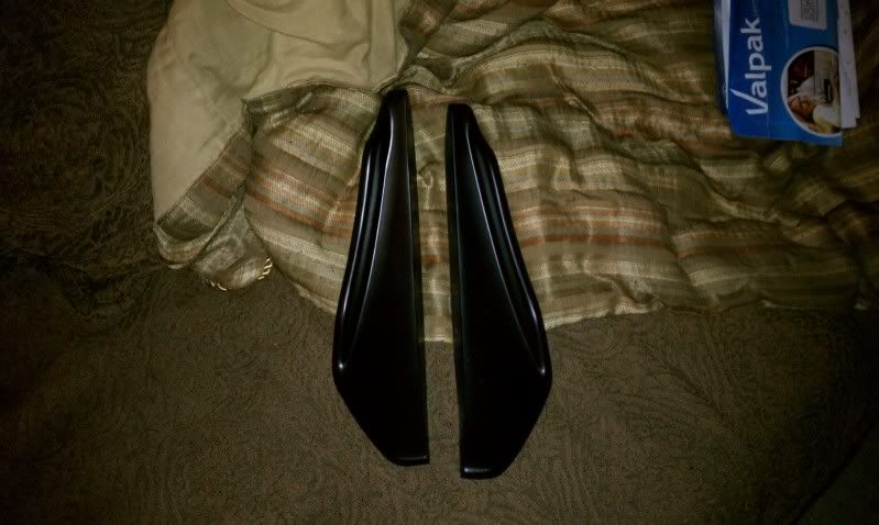

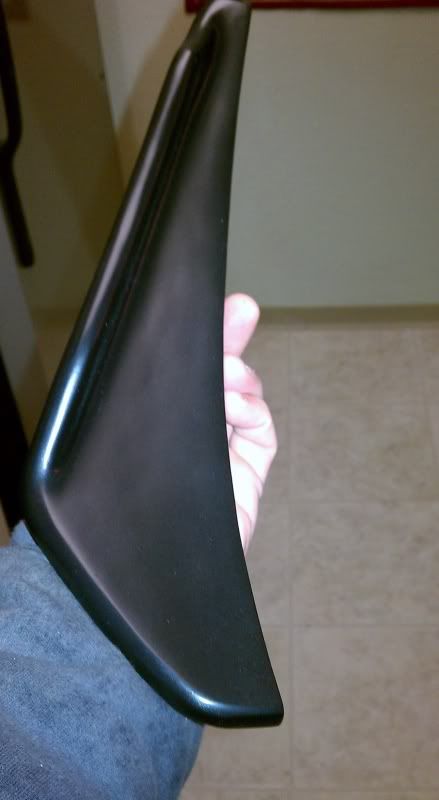

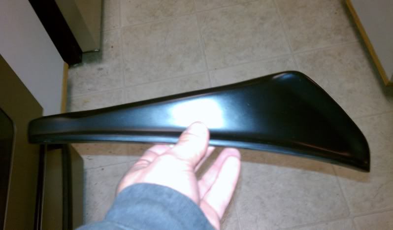

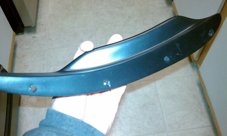

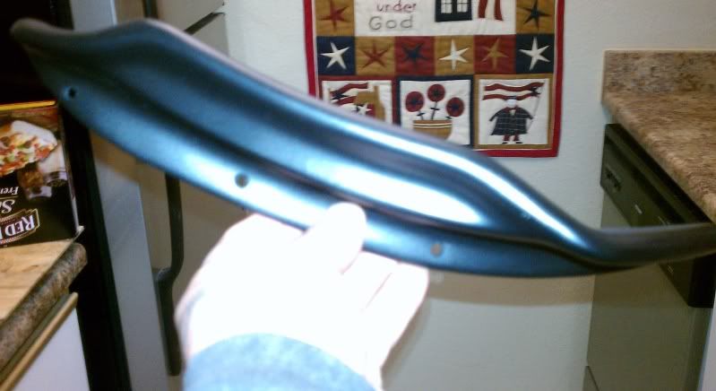

Got a package in the mail today......decided to try something totally differant so I got a set of Canards......they are somewhat universal,seem to be either fiberglass or plastic,very clean,strong,well made to be honest,I was not sure but I figured I would takea chance since I had some spare cash that came around from aside job I did......

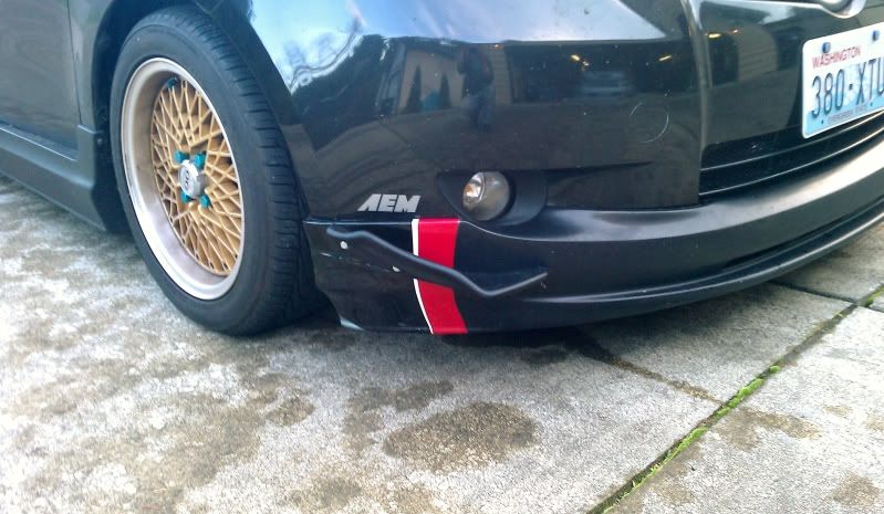

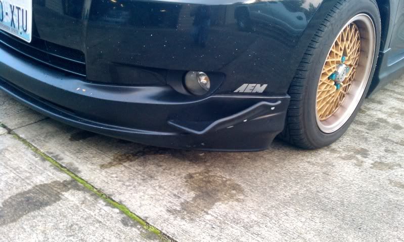

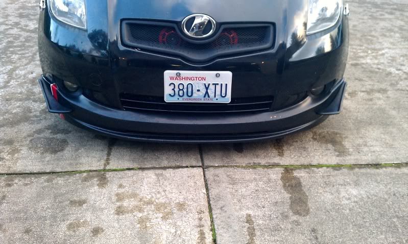

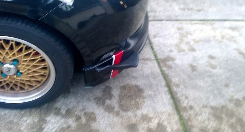

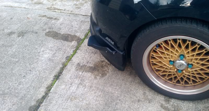

But here are the pictures of the canards installed,I tried them high and low and they looked and fit best low....I know they are kinda over the top but they are mounted now so I am stuck with them...lol
Car is also back up and running,it was the fusable link for the alternator that popped,the pullies could be giving a bit more smoothness to the acceleration but no real power gains felt,think the crank pully will make most differance once Garm gets them produced.

I think those are great! Adds a great aggressive look to it but not over the top, very clean. I was plannin on getting four of the more straight edged ones and then putting them two almost on top of each other on each side like you did and then getting one that covers the whole bottom lip. but thats not until after I put my new body kit on in the next two-ish months!
Old 11-04-2011, 03:32 AM   #13
ilikerice
ilikerice's Avatar
Drives: 2010 black yaris
Location: savannah, ga
Posts: 2,868
seem too low to me.. personally that is.. I like the idea. location just seems off..
probably need pic of the car as a whole to see how they flow with the everything

yeah actually now that I look at it I would want mine to be closer to the headlights

I totally agree....they are low.....I should of taken pic of them up on the bumper....if the lip was not on they would of been like low point at the fogs and looked really much better,the lip kinda is in the way of pulling it off without an odd angle....
Just so everyone knows,I like honest opinions....good or bad.....
I think the pair like the APR would work great on the bumper,they are shorter than these,but I got these so cheap I had to try......I will get car washed up and take some full body pics and then you can see they are indeed low,but are not too bad....lol
