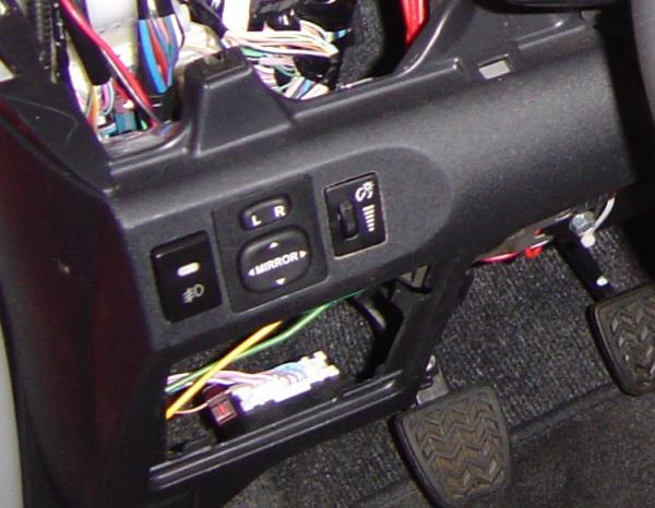

I know this is the wrong place, but this is where I put my fog switch. I'll post it up in a thread of everything at a later time. And yes, the dimmer pops out like stock.
