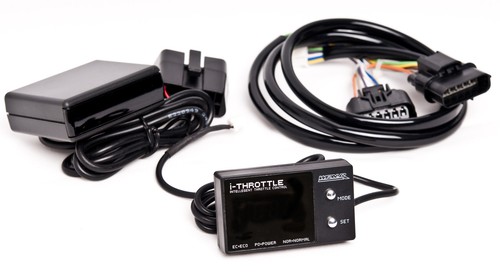

Here is the most reasonably priced plug 'n play throttle controller out now.
I have a unit, but the Yaris-specific harness that goes with it is on back order:
http://www.weapon-r.com/products/196...ontroller-unit
Blitz also makes one if you want to spend twice as much.

Hey Garm,
I didn't know anything like that even existed. Our 2012 is hypersensitive right at the beginning of the pedal stroke which makes it difficult to modulate the rpms when letting out the clutch to move from a standing start. The tendency is to overrev the engine. While I'm learning to be mindful of this sensitivity, I really miss the linear control of a cable. Would an ithrottle compensate for this?
Old 06-02-2012, 02:14 PM   #17
^ Yes, that is exactly the kind of thing it would help with. I'm not sure how many modes it has, but usually there are several available so you can choose the one that enhances your driving style the most.

i-Drive, i-Throttle, 3-Drive, Pivot, Violence - all same type of electronic throttle controllers, just different brands. Sabretooth has a DIY on it - very simple to install. Plug-n-drive :)
Here is the link to the DIY with a full write up.
