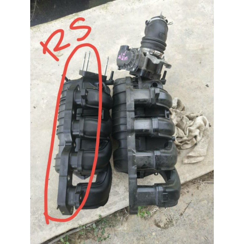

Found these guys selling RS intakes saying they produced a little better top end power and torque, it's one of the mods they do in asia.
Here a pick showing the difference, it's funny becasuse there is the mod to increase the size again from the longer version, which they said lowers where you get the torque but will decrease hp and toyota does know what they are doing and the best NA cars have short stacks not long ones.
