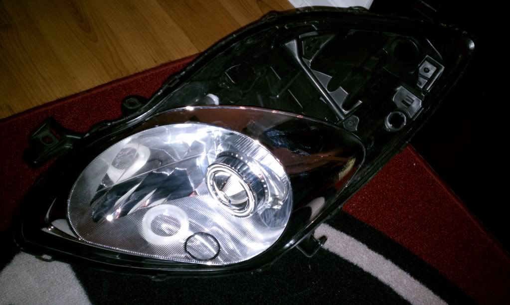

This is where I'm at right now.
The only way the projector seems to fit in there with any remoteness of security is without the thin washer and without that rubber grommet. Even then, it feels like it might come loose after driving a while and the projector bouncing around in my bowl is not what I spent $200 for.

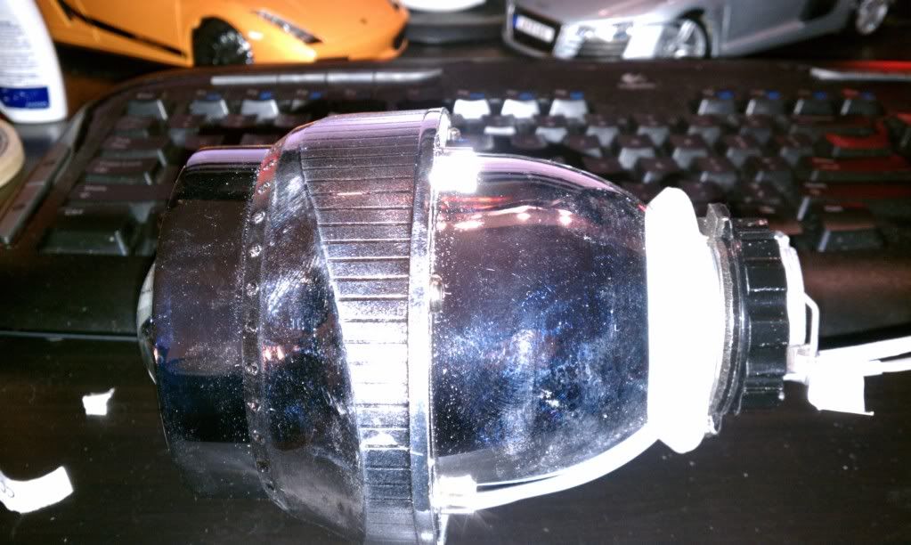

This is the untouched second projector, as it was when I pulled it out of the box. I haven't touched the order of the grommet or any of the rings. The only thing I did was take out the bulb.

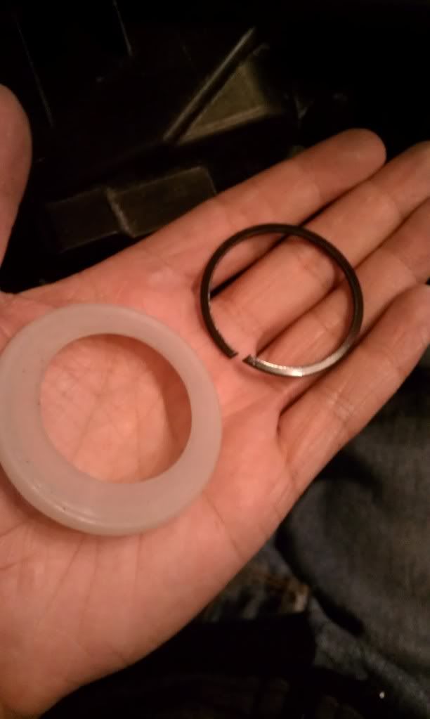

These two pieces don't seem to have a home, and unless I am blind, I'm not seeing where they get inserted in either how-to. And here I thought the hard part would be getting the headlights apart and getting all the wiring done. Getting them apart was a breeze. Haven't even started the wiring yet because I can't get these Goddamn things to work. Even if I do, I have no idea how I'm gonna seal my lights back up.

The white rubber piece goes inside and sits against the reflector bowl. Then the locking washer and nut secure it from the back. You can go without any of the locking rings, washer, or white rubber piece. Check Home Depot for "Sika Fast Setting Anchoring Adhesive" and you can permanently attach the projector to the bowl. Just make sure the cutoff is straight.

I had figured that might be where the rubber piece goes, however when I put it in there on the back of the projector, I can't seem to get enough threads through the slot in order to crank down on the locking ring.

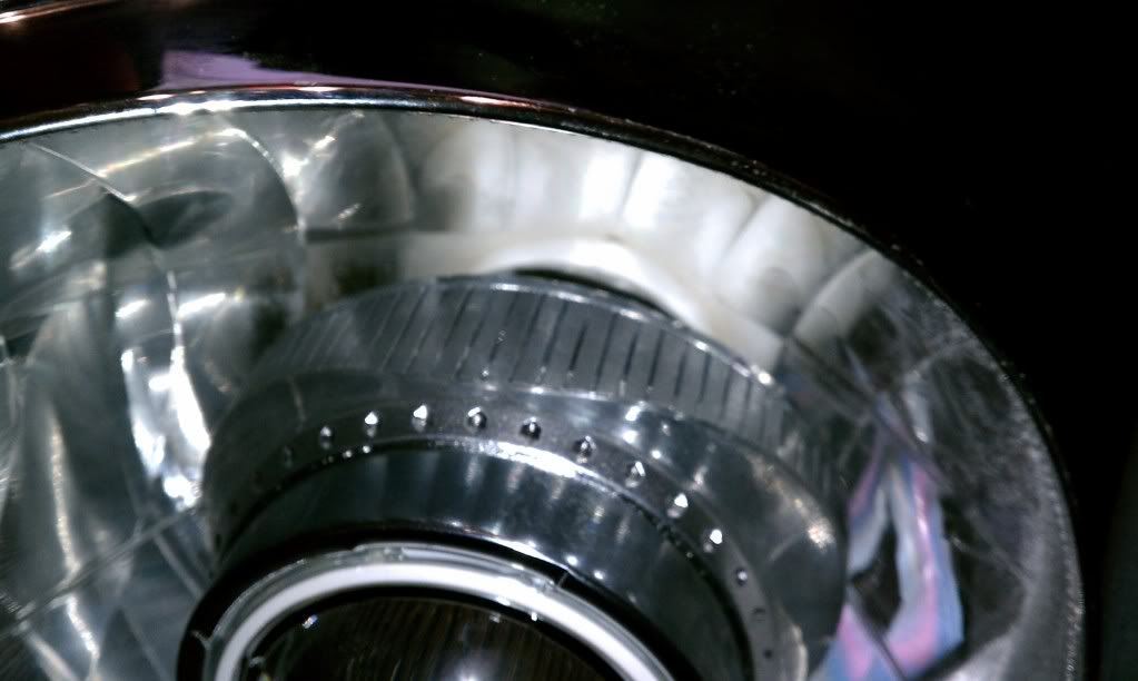

Ok, here is the white rubber piece against the reflector bowl. I managed to push hard enough to get enough threads thru to crank down on the locking screw.
Does everything look right back here?

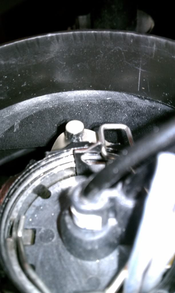

My only problem now seems to be that the little U hook that the clip that secures the bulb snaps into is bent. As seen here.

Everything looks okay to me. Not sure about the led's since mine didn't have them.

Yeah, this is the Gen 3 kit from Garm. The projector does seem more secure with the rubber bit in the back. The LED backlights seem to have their own cords and even a controller with a 3M sticky pad on the back to place it in the engine bay or something so that you can change the colors. All of that seems a little excessive.

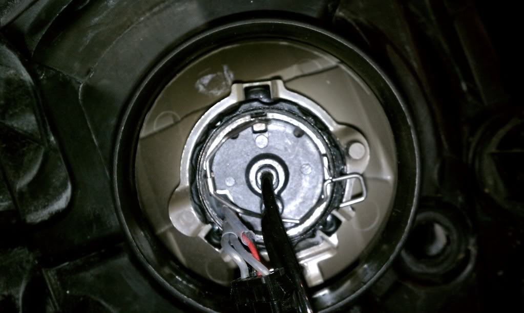

for the pic of the back of the headlight i cut off all the "extra" stuff that sticks out so the projector nut would sit flush and screw on all the way

also did u bend the 2 parts that hold down the bulb locking bar? i had to bend mine to get them in and i had aiming issues with one of the projectors cuz the bulb wasnt sitting perfectly flush cuz i hadent bent the clips back close enough to where they were originally

Yeah, I did have to bend those but I used a pair of tiny needle nose pliers and bent them back.
