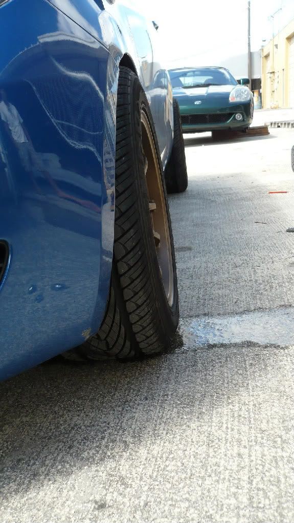

that's an 8" wide wheel in +20mm offset and a 225 wide tire.
and same wheel and tire with an effective offset of +7mm
hope this gives you a point of reference
Old 11-17-2009, 12:30 PM   #5
RacerFreakXXX
JDM Fred
Drives: 06 Mazda Miata
Location: Somers NY
Posts: 787
Send a message via AIM to RacerFreakXXX
are those 15x8? and what wheels are those again, I know you had mentioned them to me.

Posts: 4,916
15X8 TRmotorsports C1's

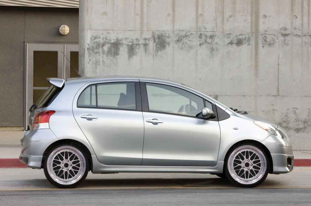

Send a message via AIM to Dj_SloKid Send a message via Yahoo to Dj_SloKid
this is the llok im going for, (but lower of course)
