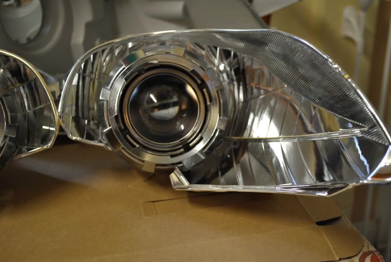

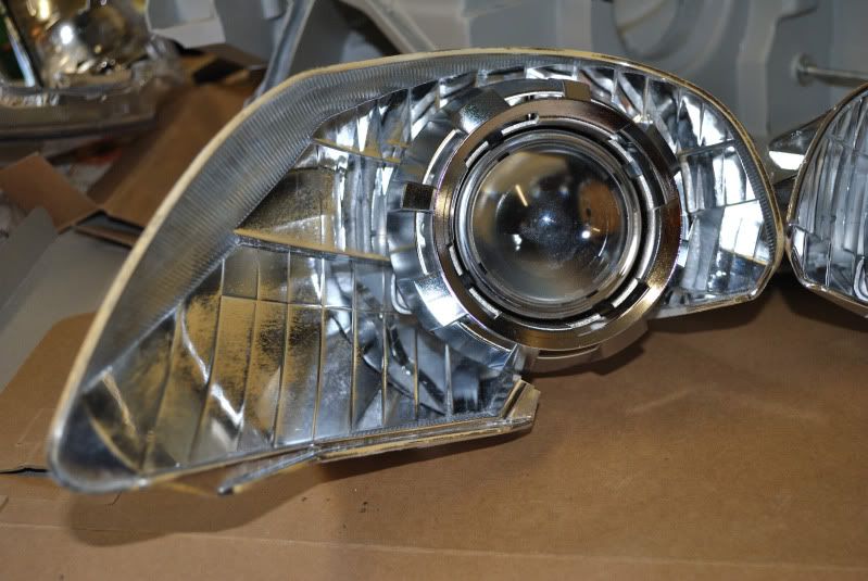

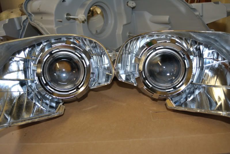

Here is my progress so far. Lens removed, sealant removed, bowl removed and modified. Projector fits nicely to the rear of the bowl. I had to trim 1/4" from the shroud to clear part of the bowl. Here are some pics of my progress.
Modified reflector bowl
Projector inside the reflector bowl
At this point, the factory adjustment knobs will still be functional. Not sure if they will be once everything is together.

Bowl modification complete.
