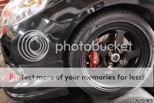

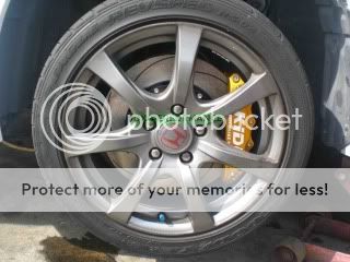

Here's some pics of kits installed.
We have few Yaris(USDM) and Vios(JDM version of yaris) installed with the KIDO BBKs.
And some other cars too..
