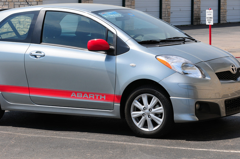

I have seen more than a few Abarths here in SC ...
They are all over the place... It takes more than a set of stickers to make a car a model that is not sold here. Yet. There are certainly "tribute" cars out there. Fiat even lets you order the 500 with some stickers.
