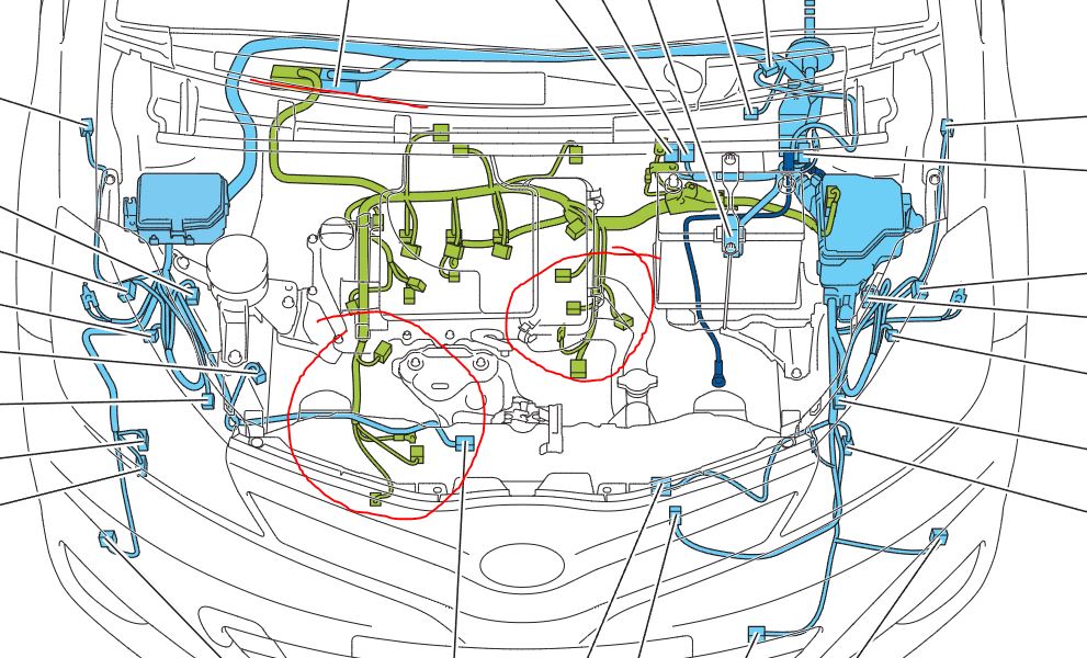

In the meantime, I found this electric diagram of the 1NR-FE. Seems I need to disconnect all these connectors here and hopefully I'll be good to go. But like I mentioned, most likely I need to get the car on ramps, take out the splash guard and get to these connectors from below...
On my 1974 VW beetle it took about two seconds to get the valve cover off!

unbolt the harness and dissconnect it then "roll" it out of the way, youll have to dissconnect all the way down to the ac/alt to get the movement you need
Thanks, seems this is the answer I was looking for. And it's basically necessary to get under the car, right?
And on the right side, better to disconnect as well lamba sensor, etc? Or is this one not necessary?

on the 1.5, looking at it from the front, only the BELT side stuff needs to come off, the battery side stuff can remain
i was in there a couple months back..and didnt touch anything on the starter side..also getting under the car is NOT a requirement, the only tricky bit is the crank pot plug and bolt which can be accessed with the car on the ground and the wheel turned
