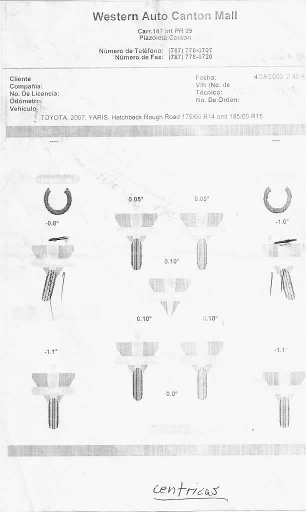

I noticed a problem with the alignment, to drive in a straight line I had to hold the wheel a bit to the right.
I got an alignment job done today and they said the cause was a missing bolt or part on each front tire ( I'm hispanic so I don't know the name in english sorry!) the told me these were called "centricas" and without them my car was pulling to the right.

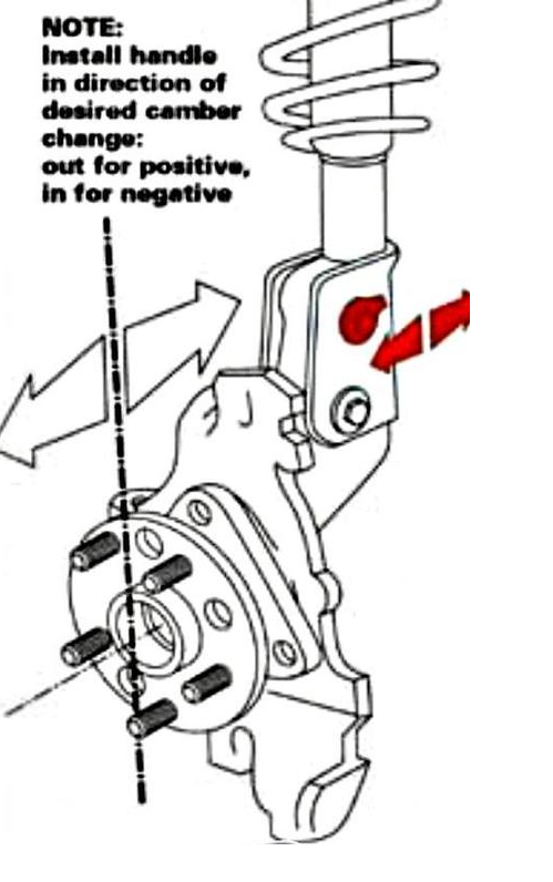

okay so today a bud and I lifted the car and the camber bolts (said to be bad) looked normal.
Here is a pic of the ones I bought for $35.00(the pair)
is this the thing I'm supposed to replace?
are they better than the OEM ones currently installed? I understand these are adjustable.
this is a picture of the bolt that needs to be replaced on each front tire according to advanceautoparts(the red bolt is the one pictured above)

here is a pic of my alignment in the first place.
